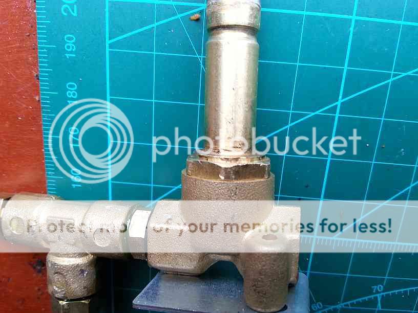

    I disassembled it to replace the o-ring in the valve or tighten it, but it wasn't as simple as that. This is what I found:
    You can see the split brass at the base of that nut there, never seen anything like it before, not sure if a lot of use or manufacturing defect was the problem here. I ordered a new solenoid.

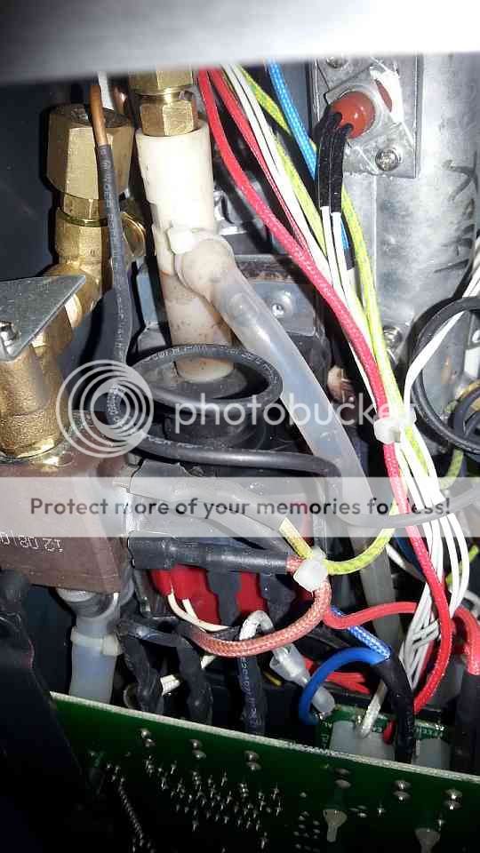

    Here's the result:
    Not gonna lie, I dunno why this happened. The neutral wire to the solenoid has literally exploded out of it. The crackling noise and restricted flow must have been the coil shorting and semi-closing the valve. There was no visible damage or water leaks near the solenoid so I don't know what caused it.
    If anyone has any ideas on why this happened or have experienced it before, let me know. Probably not going to bother repairing it any more unless the company I bought the solenoid off will replace it. Unless someone has a spare solenoid they'd be willing to let go cheap?

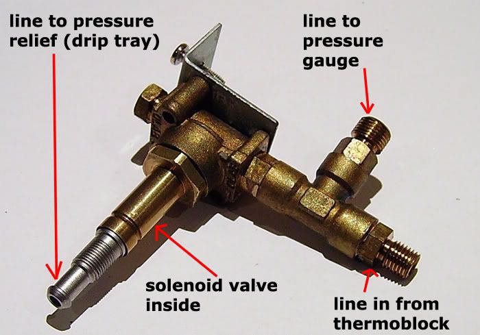

    Thanks man, this is a picture i found of it cos i don't have a proper picture. It has a small black or brown box around part of it with 3 wires coming out.
    I also took the solenoid coil (the small black or brown box) off it today and found that the brass had split again, causing a massive water leak into the coil which caused it to explode. I can't explain why this happened, the valve was working properly up until this point where it's just failed again. I can't understand it.

    Here's some photo's of the damage to the solenoid this time around. Organised for a replacement solenoid now, i'll be checking the machine to see if there's a reason that it's killed 2 solenoids, can't see what it'd be seeing as the machine works perfectly when it is working at least.
