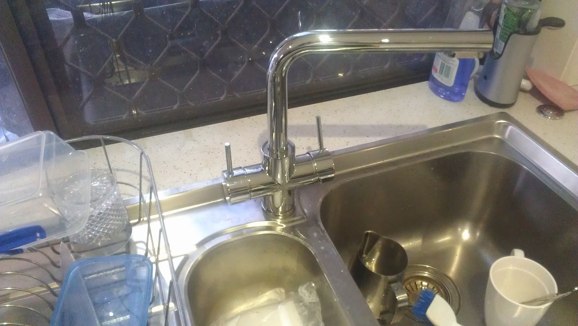

    I would not have thought you would need to run a drain into the sink. Just loop the drain hose up as high as you can under the bench so nothing can drain back if there is water in the sink and run it to a dishwasher drain outlet under the sink. I thought about plumbing mine in but it was not designed for that so did not bother in the end. I have a double cartridge filter under the sink for both the fridge and a cool tap (that cost me $500) that has an extra outlet for it for the filtered water so there was no extra spout for the filtered water sticking up. Got it from Reece Plumbing.
    Found a pic of the dual outlet tap
    Left side is filtered water, right side is a standard flickmixer, sorry bout the washing up!
