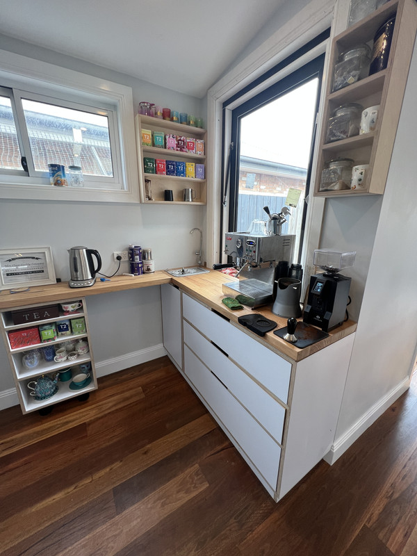

    Finally 95% finished. Still just to finish plumbing of the jug rinser and filtered water tap and the front bench top.
    I will post a final pic from outside when the final bench top is fitted to the deck area... pretty happy with how it all came out...
    Mark
  • markeaust
    I know it’s been a very long time. Owner Building is a tough game, add in Covid, family commitments and full time work and glacier speed ensues.
    Progress so far…..
    Hope you like it so far….
    mark

    Hi All,
    Not much to add at this point as have had some hold-ups with COVID lockdowns and work interfering with renovations. But.... I have moved things into position, temporarily, just to sort out workflow before everything is 'cemented' in. I've started on cabinetry and still waiting for the window (obviously), but just happy to be "in-situ"... Will post progress in the future..

  • markeaust
    Gents,
    Thanks for the replies so far. I will take all on board:
    1. Bench space. I agree with the suggestions above in this regard. I have been looking for a really small bar sink, but given the comments, I reckon I might leave that idea out and perhaps just put in a jug rinser, way over to the left and given I already have a filtered water tap, could position that over the rinser to catch the drips. Kill 2 birds with one stone.... The image created by the architect is relative only. I wouldn't have a sink anywhere near that big. Benches will be recycled Messmate hardwood, self made, so anything is possible. I'm looking at extending the bench into an 'L' shape as shown on the pic below.... there's enough room if I keep it quite narrow, say 300mm (I'm making all my own cabinets, bench tops, drawers etc... kill me now... ;-). )
    2. Regarding upgraditis, I doubt that I will get any sort of machine that is MUCH bigger than the Lelit. Was thinking of the Profitec or similar and likewise with the grinder. Thinking Eureka 65 or similar.... but always $$ dependant.
    3. From the above pic, you can see where the fridge will be. We decided that it just stuck out too far in the original plans and better to place in the pantry. There won't be a door on the pantry either and the entry is wider than depicted. It's only a couple of steps from the coffee bench to the fridge. I think I can live with this.
    Thanks again.... this has given me some new ideas which is much appreciated.
    Mark
