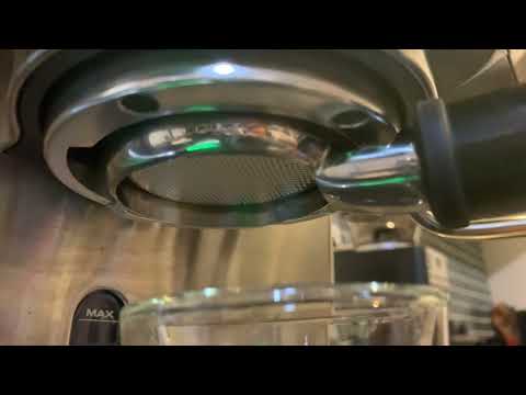

    (V) Video... it's awful

    It might help if you can post a private video of your puck prep and shot from the bottomless to YouTube and link it here for review.
