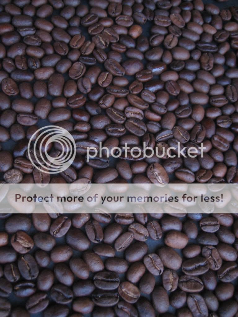

  • damienh7
    Re: First Roast: Peru Popper Roast
    Originally posted by 353B3B25722B33323B5C0 link=1309504665/3#3 date=1309507865
    normally, is stopping the roast just after 2nd crack best practice?
    Really depends.  I think either just after, or just before (unless you have a way to track temp, this would really involve a bit of guess work!) is generally the accepted norm.
    I find this bean pretty forgiving.  Lighter roast will bring out more of the beans flavour and complexity.  Darker the roast, the more you will get a chocolatey taste, and lose some of the beans natural flavour characteristics...  this is often considered a bad thing, but i quite like the cocoa/chocolate flavours, so going into 2nd crack is no real issue for me!
  • iggs
    thanks for feedback guys
    any other roasting tips for a newbie?
  • damienh7
    Looks pretty nice... quite even for a popper roast from what I can see.
    They certainly dont look burnt to me... generally with 2nd crack youll get a bit of smoke. If you didnt get that, chances are youve pulled them prior to 2C, although looking at the colour (which can be deceptive on a computer screen) you mustve been close.
  • shapeshifter
    I dont think you hit second crack from the looks of them but I could be wrong.
    I did 3 lots of Peru on Monday in my popper and the time between 1C and 2C ranged from 4-7 minutes, total time including a 3 minute cooling time ranged from 18-21 minutes.
    People say that 4 minutes is the best time between 1C and 2C I dont know why though.
  • iggs
    started a topic First Roast: Peru Popper Roast
    Hi all
    Did my first ever roast today ( Peru Ceja de Selva Estate in unmodified Sunbeam Cornelius Popper).  What do you think?
    I think its a bit uneven but overall im pleasantly surprised
    info
    100g green beans
    1st Crack began 2:33
    Finished approx 6:00
    Ambient Temp approx 16 degrees
    Roast Temp: Unknown (need to get a thermometer/thermocouple)
    Questions
    How long is first crack suppose to go for?
    I couldnt hear a second crack...but then I started getting worried id burn the beans so stopped it the roast.  When should i be expecting the second crack?
    its in a one way valve bag now, going to let it rest a few days then will do the first tast test.  cant wait!
