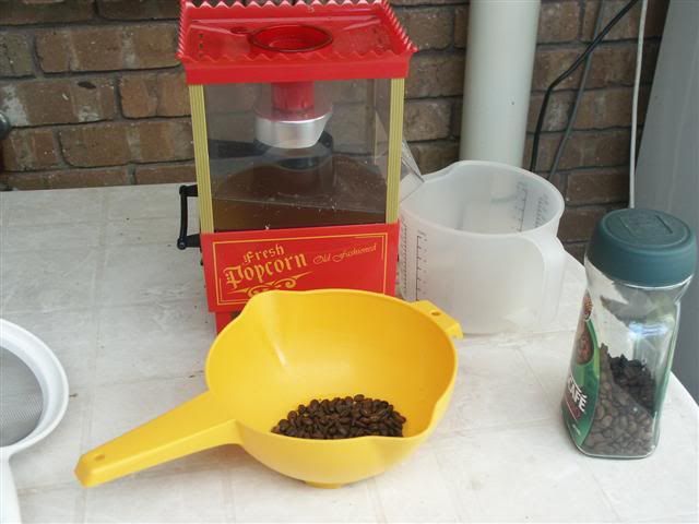

    I used 1/4 cup of Colombian beans, first crack was at 3.30 min second crack after 4.00 mins , removed beans after 5.mins.
    The beans look reasonable Ill leave them for a few days before I try them.

    Im new to roasting also - from what ive read, those beans may look a bit too oily, and perhaps not consistently roasted?
    Seems a really close time between cracks. Perhaps you could open the roaster up a bit to allow better air flow? (mine is the opposite problem of too long between cracks)
    Ive not seen the type of popcorn maker youve used in a coffee set up before - is it an air blower type with vents on the side walls of the roasting chamber?

      Hi, Yes its the blower type with vents on the side walls of the roasting chamber, Target sell them.
      That photo has two batches of beans I roasted, the oily beans were roasted a little longer (maybe too long)
      I still need lots of practice

        1/4 of a cup was probably too little, if the middle section is the same as all the other poppers you need around 80-100 grams.
        Definitely too oily, roasted too long. They might taste a little burnt Id say.
        Keep at it, youll get there
          More beans less time , thanks
            Re: My first crack at roasting with a popcorn popper
            dolmar you might find, or should find that you wont need less time, with more beans it will take more time to get to the stage youve got too. The timings you originally put up are about right for an unmodified popper, you might be able to extend it a little depending on temperature, but with more beans you definitely shouldnt get to burnt stage in 5 minutes (fingers crossed)

                I roast with a cheap $12 popper.  I found that my times were only about 4 mins in total at first, but as the popper has aged the times have lengthened.  Its as if the heating element has broken in and is weaker than it was brand new.  Now my times for about 100g are about 5-6 mins to first crack and second about 8-9 mins, depending on the weather.
                So maybe the times will get longer as your popper ages like mine did.
                Also, if you havent already, place a small 20mm thick piece of wood under one side of the the popper so it sits at a slight angle.  I find that it helps with the circulation of the beans as they roast.  Rather than the beans just spinning around, they have more of a tumbling action and it helps give slightly more even roasts (and possibly slightly longer roasting times).

                  I just made a coffee with the beans I roasted last week, slightly over roasted but it tasted pretty good.
                  Ill roast with the popper on an angle next time, like you suggest tumbling rather than spinning should give a more even roast.

                    Just finished my 2nd session of roasting with a popper. First time round it took about 4-5 mins total. This time it was similar to Bansaiboy. 5 mins to 1st crack then 8 mins for 2nd crack. Colour and aroma seem right.
                    Ill admit to having great difficulty hearing the 2nd crack. The machines make a lot of noise which drown it out. I can also recommend tilting the machine. The beans spin like crazy when you keep the machine flat but the angle lets them tumble and circulate well.
                      When I was roasting with a Popper, I found it easier to hear the Cracks if I stood back from the Popper a metre or two. The fan noise subsides a little but the Cracks seem to penetrate through enough to be more easily heard....

                          Thats a little odd, my first roast was this weekend, with exactly the same popper, around the same roasting times and  a similarly slightly overdone beans
                          I did two batches one after the other, second batch slightly more beans which seemed to take less time to get to the second crack, perhaps because the machine was already pretty warm.
                          Will try the tilt for my next roast, and take the beans out at the second crack, which I could hear quite well on mine, once Id learned what to listen for!

                            Those beans look good, I have the same popper I found its not powerful enough to move the beans around when tilted.
                            Ive upgraded to a breadmaker/heat gun setup, I can now roast 500 grams at a time, 80 grams with a popper was becoming a PIA
