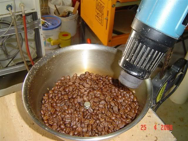

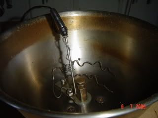

  • Javaphile
    Re: What is best - popcorn or heat gun
    Nice set-up Billi.
    You can also use an old computer power supply for your 12 volts and if the agitation is too fast you can drop the voltage to either 7 or 5 volts by swapping around a couple of wires. It could easily be modded into your existing box it looks like and would help to keep the motor cool there-by extending its lifespan.
    Java "Inventors R Us" phile
    Good one Billi [smiley=thumbsup.gif],
    And , its very neatly done too and with its own box and everything..... a very snobbish roast setup 8-) ,

  • Billi
    My 2c.
    You don’t have to ”stand there for 10 + min.”, when using a heat gun.   A simple mod, is to add a motor and stirrer to the dog bowl, most seem to find the windscreen wiper motor from the wreckers for about $10 and an old battery, usually to be found lying around somewhere, will do the trick.
    Here is my set up:-
    Bruce
