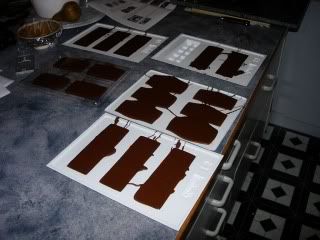

    I now have my chocolate factory up and running! Did my first batch on the weekend and will start my second batch tomorrow.
    Roasted in my corretto, cracked in a Crankandstein cocoa mill and then winnowed in a large bowl with a hairdryer. Sorry didnt take any pics of these parts. I might add some later of the next batch.
    Next I followed Dennis method of making cocoa liquor in a food processor. Again, no pics but see Dennis above...mine looked just like that. It is an amazing process to watch unfold in front of your eyes.
    From there I melted some cocoa butter over the stove and poured into the cocoa liquor still in the food processor and mixed together with a quick spurt on the processor again.

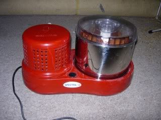

    The next part needed my new purchase, the Spectra 10, aka The Alchemists Stone, aka Santha Wet Grinder:
    Though the casing has a crack as can be seen in this photo (actually a few cracks), it seems to work fine.

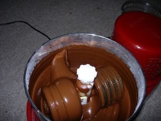

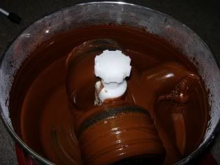

    So, in went the cocoa liquor and butter mix, sugar, milk powder and a touch of lecithin. Went for around a 60% cocoa milk chocolate.
    Using my little crappy camera so colours arent very good.
    Ran my wet grinder for 20 hours and then began my journey into the art of tempering. Had a bit of a rough time here. First one worked sort of...but I decided I wasnt happy so went again. 2nd time didnt get it at all, 3rd time worked okay but still not happy with the quality of the temper.
    But anyway, into the molds:
    The final product I hear you ask? Welllllll.......pretty good...for a first effort. Overall it all worked so I would be happy with just that for a first attempt. Beyond that, the taste is okay. I guess very good for a first attempt with a bit of a made up recipe, but only okay if you dont take this into account. Better than some chocolates available in shops, but still a long way to go. The actual cocoa is amazing, I think it is my recipe that needs quite a bit of tweaking. The temper is where it is mostly let down I think. Although it has some snap and a little gloss, it is quite inferior to the snap of most chocolate and could be more glossy. I think this is the part where I have a lot to learn.
    Overall, an amazing process and lots of fun. Not as messy as I expected and the only potentially frustrating part is learning the tempering IMO. A hobby I am looking forward to endulging for many years to come
