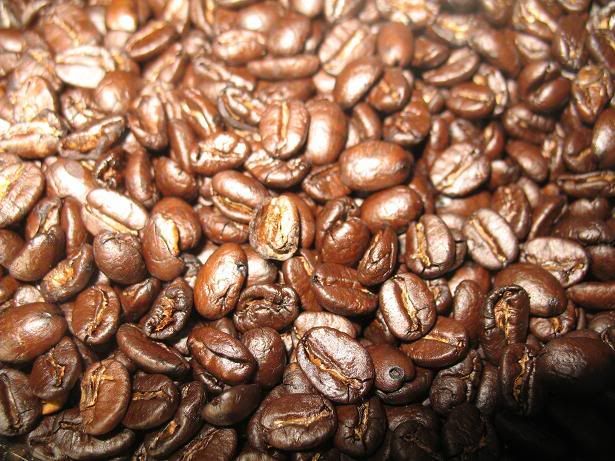

    As an aside, the beans pictured kind of smell a bit burned ... I told my wife that they take a while to mellow out after roasting but does this actually apply to the aroma? They dont look burned, as you can see, but Im hoping the aroma improves in the next 48 hours as well as the flavour.

    Looks grouse, Stuart. /thumbs up/

    Thats a nice looking roast Stuart. Cant wait to hear how it tastes.

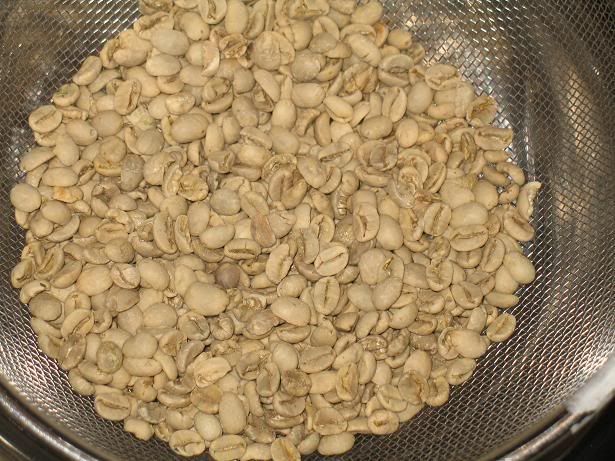

    Well I posted somewhere else this morning that Id received my starter pack and was itching to roast some of it, pending the completion of a Corretto roaster my friend and I are making.
    But I couldnt resist jumping the gun, as it turns out.
    I mounted the heat gun on a bottle capper (a la the original Corretto) and stirred the beans manually in a sieve-in-a-dish. Just 120g as a test run. I also chose what I assumed to be the most "expendable" origin in my starter pack (the Australian! How unpatriotic...) in case I stuffed it up. After all, this was also my first roast.

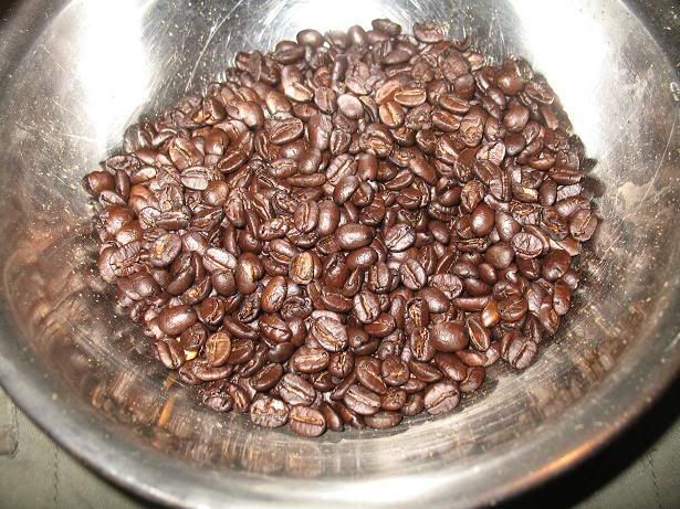

    Roast profile was hard to pick (see below), but times were: 8:30 - first noises of first crack, 10:30 - last? noises of first crack (hard to tell), 14:30 - second crack seemed to start, 15:30 - heat off (started smoking during last 10 seconds).
    Roast is quite dark - that final 20-30 seconds really made a difference. Ill know to cut it a bit earlier next time.
    I started with 120g, spilt 5g and ended up with 94g = 18% loss. This is on the high side of normal from what Ive read...

    Before, parts 1 and 2:
    After, parts 1 and 2:
