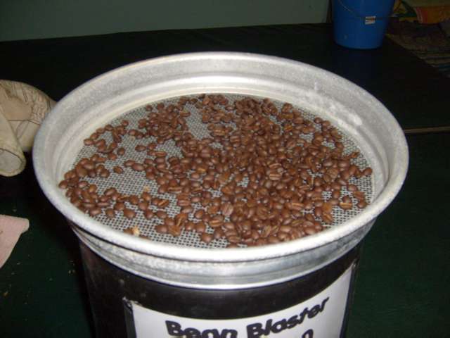

.yeah as the other posts have said ,, camping stores are the go , I picked up two for $40 the other was nested inside the one I used , but had a bigger mesh size , I thought the smaller mesh size would give more cooling effect (like metal to bean ) but I will try the other one and keep everyone posted , and take a few pics as well , Cheers Gaz, ps look forward to the posts KK
