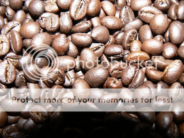

    Hi Guys & Girls
    I just had a go at roasting with a lid on the BM instead of using the standard lid I removed the metal liner and used it on its own ,Worked great I had the best control I have ever had over the heat and ended up with a very nice even roast about C-8..
    With the lid on my chaff catcher worked a treat next to no mess at all I cut a small opening in front of the pickup and the air from the heat gun doses the rest.. :
    Cheers gra

      Re: Roasting with lid
      Excellent looking roast there Gra and a good idea re: the heat baffle from the lid 8-)..... Should cut down on the amount of heat required to some extent too,

          Hi Mal
          Your spot on with the heat on the gun it was lower then normal and the control was mostly by raising and lowering, The HG never once got any closer then about 60mm to the opening so I could still keep my eye on the beans ..
