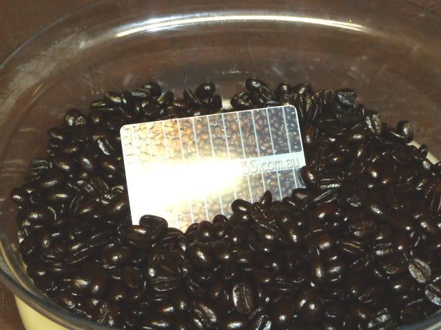

    folks, just received my Behmor 1600, burnt it in, added 300gram of peru, set it for 1 P4 C. With 8.30 remaining on the clock a rolling first crack occurred for 1.30 minutes, opened the door and smoke came pouring out, hit the cool button as the beans were dark and gleaming. Now not sure what happened as i expected a second crack but wasnt game enough to continue. ur thoughts appreciated.

    Its always hard to tell whats really going on because we have no idea of how truly the image represents what you are seeing, but judging from what I can see of the card, you have gone wayyyyy past 2nd crack!
    Those beans look like good fertiliser and time to try again, either more beans or different profile.

      Why did you use P4? They do look very black and shiny but perhaps not as bad as they could be (i.e. charcoal black).
      Let them rest and try them in about 4 days time.
      Id suggest you use the P2C setting and maybe increase the bean size to 330g.

        that looks like its gone way past R2C imo
        either that or very bad lighting lol

          clear something went wrong, will try something else this arvo, as for the pic, my image host was down and couldnt improve the pic at all, will try other settings on the camera as well

            Im guessing you might have hit rolling second crack at -8.30. I did something very similar on my first roast (not on a Behmor). Is there oil developing on the beans?
              Re: my first crack
              Barry, yes thats oil ur seeing...

                  yeah that amount of oil would only be there once a roast goes too far
                  try shortening roast time to see how it goes
                  dont worry about wasting beans
                  the 2kg given is meant for that purpose. keep going at it and you will eventually get it
