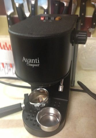

    I just bought my first espresso machine, an "Avanti Compact" model, from a private seller. It is a little known manual house brand machine that is made in Italy (by who, I'm not sure), circa 90's perhaps. Having never used an espresso machine before, apart from stovetop moka pots, I find I am unable to make "crema" with this machine. I am now starting to wonder if the machine itself is unable to make crema; either because of some defect I know nothing about, or it just isn't up to par. It is a pump-driven machine with quality parts, ie. heavy brass non-pressurized portafilter, but whether it goes to 9 bar or 15, etc. I don't know. It's a discontinued model, can't get info on it.
    I use a whole bean espresso from Costco called "Moretto" brand. I grind using the Braun KMM30 (aka Type 3045) variable burr grinder, from settings 3 to 5, as suggested by the seller. The shot takes about 25 seconds, a standard time, from the time the button is pressed. I tamp using a plastic tamper, with about as much pressure as I can get on it. (Anyway, it's not the tamper or the grinder. The seller showed me a perfectly fine crema on his Saeco Aroma, with the same tamper and he uses the same grinder). I've tried another brand of coffee as well. The closest I've ever come to crema on this machine is a tiny bit of blond foam that quickly went away. What is wrong here?
    Sounds like stale beans to me. Get some fresh roasted beans from your local coffee house/roaster and try them. Also is that basket a single or double walled one? When you hold it up to the light can you see through all the holes? Can you see all the holes looking at the basket from the bottom or is there just one?

          Thanks guys for helping me get to the bottom of this. Well, the espresso beans are fresh, in that it's a new bag, I just bought them from Costco. And the grinding is done just before the brewing. Plus, the seller I bought the machine from uses "Lavazza" pre-ground on his Saeco Aroma, and he made a fine cup for me with plenty crema. So this evening, I tried a bag of pre-ground (bold) espresso coffee, that is a grind for moka pots. I usually use 2T coffee in the portafilter (it's about as much as I feel is safe to drink, per person). With this coffee I fully loaded the portafilter, shaved off the excess, tamped it down not too hard (as suggested by the seller). This time it produced some light crema-like froth. A bit on the first try, and enough to cover the top lightly on the 2nd try. I mean, i don't think this is true crema, but at least it isn't all black!
          What do you guys think about this crema?:
          First shot
          Second shot (the cup was filled with more water)
          This is the basket
          . I "believe" it is single-walled, but I'm not sure how to spot the difference. I know the portafilter is non-pressurized, and I can see light through all the holes that cover the bottom of the basket, from both sides.
          The portafilter:
          In order to test the "technique" theory, what part of that would I need to work on to create a crema?
            Just because you bought the beans from Costco today does not mean they are fresh. They could be literally over a year old. Both of the images you posted showing the 'crema' are a thin weak anemic looking excuse for crema. Real crema has a dark rich looking appearance and fresh from the portafilter will present as half or even more of the volume of the espresso shot. When you have a lightly colored thin layer of it it says one of two things. Seriously over-extracted coffee and/or old stale beans.
            So again, go to a local roaster and buy freshly roasted beans. Freshly roasted as in the beans were roasted with-in the last few days, a week at the most. If the shop can't say with certainty exactly what day the beans were roasted walk away and find a roaster who can tell you exactly when the beans were roasted. Buy only whole beans. Do not have the beans ground at the point of purchase! Properly stored beans will typically remain fresh for ~3 weeks.
            As to how much coffee should be put in the basket it needs to be filled to the proper level in order to get a good quality espresso shot. Judging from the apparent size of your basket it will most likely take 15-21 grams of ground coffee to fill it to the proper level. To start with with the basket in the portafilter fill it with ground coffee until it is mounded over the top of it. Tap the bottom of the portafilter gently on a pad or towel 2 or 3 times to help settle the grounds and then using a finger, knife or some other straight edge item to scrape it across the top of the basket/portafilter so the coffee is level with the top. Then tamp using 10-15kg's of force. (The exact amount doesn't have to be an exact number, you just need to be able to tamp with the same force consistently. Then lost the portafilter in place on the espresso machine and remove it. You should not be able to see an impression of the machines screen on the top of the puck. Then with the portafilter locked in place start the shot and extract 60ml of espresso, including the crema in the volume. It should take 25-30 seconds to extract the 60ml. If it takes less then you need to make your grind finer. If it takes longer then you grind needs to be coarser.

                    Note that the Saeco Aroma has a pressurised portafilter meaning it will aerate and produce froth on a cup of liquid mud.

                            True crema, as understood by most members of this forum, is a sort of emulsion of the fats and oils (and other goodies) from the beans, suspended in tiny bubbles of air and CO2 - or something like that.
                            This is only produced from fresh coffee as it releases CO2.
                            Other faux-crema can be produced by frothing coffee through a pressurised portafilter or double wall basket.
                            You can not produce the
                            faux-crema from your machine because you have a standard single wall basket.
                            You will only get
                            (true) crema with fresh coffee.

                              Hi Gavalia
                              I think the point tashie was making is that many consumer machines use pressurised baskets (like the Saeco, and probably the Cuisinart you mention - and even pod machines to some degree). These machines basically froth the coffee as it comes out. This gives a fake crema of sorts, even from stale coffee. They make them like this for precisely that reason.
                              Your machine however is modeled on a commercial style setup with a non-pressurised basket. This setup will not produce crema with stale beans. It is not designed to froth, but extract coffee properly. And only fresh beans give off the CO2 that creates proper cream. So in reality, if you are unwilling to buy fresh beans which still contain CO2 – you may have to put up with you coffee without a good crema. Or buy a cheaper machine with a pressurised basket that by using smoke and mirrors makes it look like you have a good crema.
