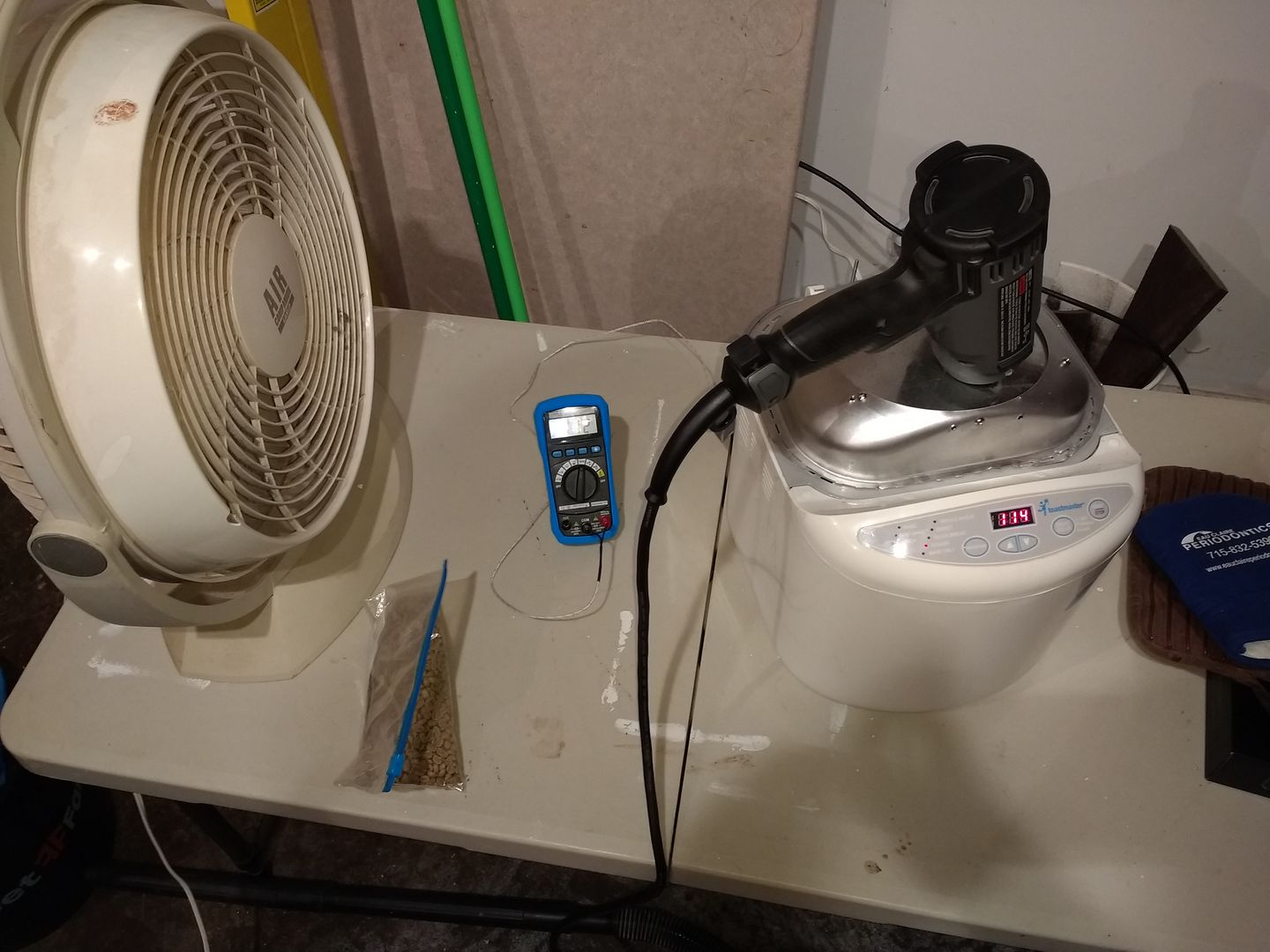

    Hello! I just built a Corretto roaster and roasted some Ethiopia Guji Alaka beans from Happy Mug. I am using a thermocouple to monitor temperature and hit first crack around 8-9 minutes in. Unfortunately, right in the middle of first crack my bread machine paddle stopped turning. I tried to fiddle with it but couldn't get it to start again, so I dumped the beans because I was worried they'd burn with no paddle movement.
    I was going for a light city roast, and although I probably pulled them a bit early, I think they look pretty good. I really enjoy SW roasting coffee, and my beans look very similar in color to theirs, so I'm hopeful that they'll taste good, but also am prepared for the worst!
    I think there is a French bread program on my bread machine that has a much longer dough cycle, so I am going to try that next time. Also, I believe it overheated, so I should also probably try to locate and remove the temperature sensor.
    It's a Toastmaster TBR15 if anyone happens to have any experience with that machine. Anyways, here are some pics. What suggestions or feedback do you folks have? Thanks!

    Try to modify the bread maker to run continuously (disable the element) will make life a lot simpler, 8/9 mins to first crack seems fast to me, you must have had the heat cranked up pretty high, I usually hit FC at around 14 mins @ about 200°C.

                I removed the heating element from the bread machine. Unscrewed it and disconnected the two wires. Will this prevent the overheating error or is there a sensor somewhere I also need to disconnect?

                    Can you give us some photos of the internals?
                    Will help us to assist you with any mod's that might be possible...

                      As Mal mentioned, some photos will help. If you BM is anything like a Breville, there may be a little screwed in metal plate/tab in the side of the internal metal skin, which sometimes has two white wires attached? I believe this is the sensor which will trip out the unit if it gets too hot. On my first machine, I unscrewed this, taped it up and tucked it away near the front of the machine under the touch pad to keep it cooler, which helped even with standard dough cycles (in later versions of roaster this has been removed altogether).
                      The other thing which can help is to wrap your pan in fire blanket ($10 from bunnings) to insulate this from the working machine. This also has the added advantage of then requiring far less heat input from your gun to get a good profile … reducing the risk of scorching

                        Aah! Bunnings fire blanket.... Just the thing, I have wrapped the outer skin in that heat proof foam with the shiny backing.

                          I just roasted my second batch, and this time I used the French bread setting, which has an 18 min dough cycle, which is perfect. The bread machine did not overheat and everything went really smoothly.
                          I went a bit slower this time and managed to hit FC around 9-10 minutes. I let FC finish and let them roast for another minute or so before dumping them. They look great and after about an hour now, they smell incredible, just like the first batch. Hopefully they taste every bit as good too.
