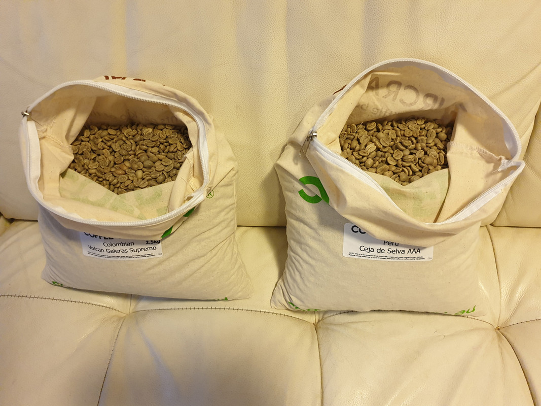

    Hi all

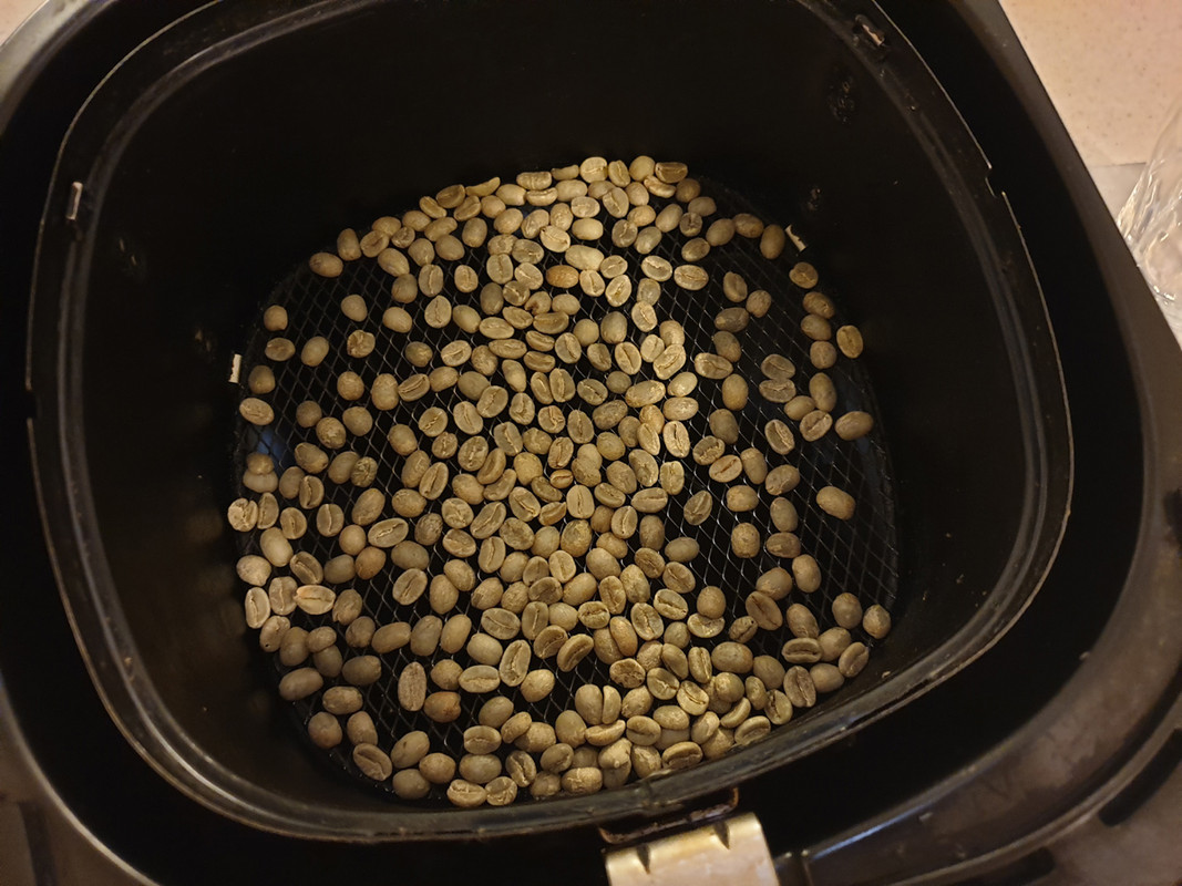

    I decided to get into home roasting, and ordered Colombia and Peru beans which arrived yesterday.
    Problem is my local supplier won't have the Gene Cafe roaster in until later this month.

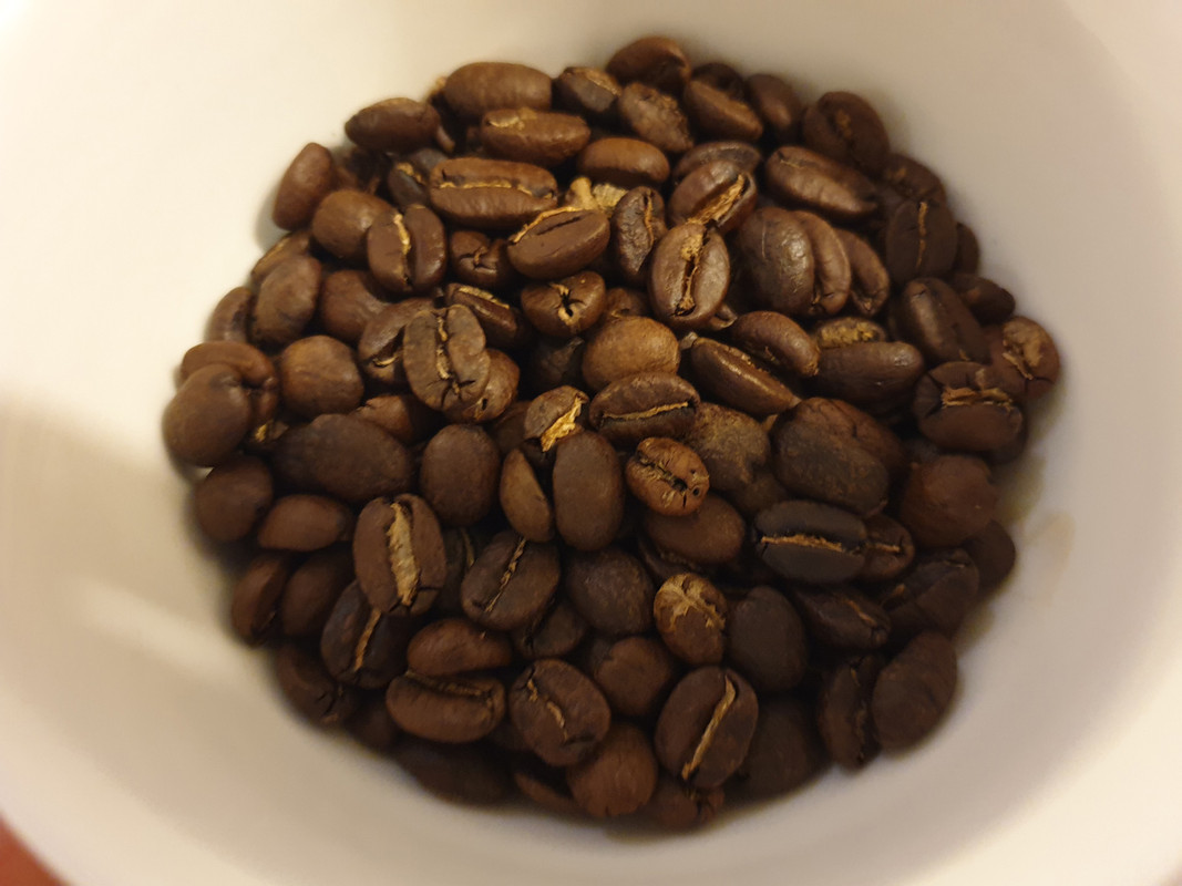

    Itching to try some roasting, I roasted a small quantity in my air fryer.
    I used the highest setting (200 degrees C), and 10 minutes, taking it out mid-way to take a photo and shake it. Not sure if it even went past the 1st crack, given I left the air fryer out in the balcony. I did another 3 minutes to see if I could get it darker, and to listen out for a crack, but no luck.

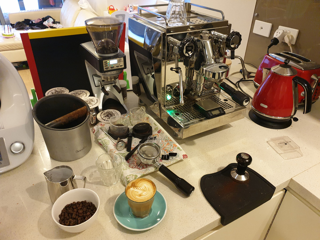

    It looks okay to me, but I guess I won't know for another few days until I let the beans de-gas and try them out. The last photo is a coffee I made using Campos Superior, which is my favourite blend.
    That's not a bad looking roast. Looks like it might have reached or went past first crack based on colour but 200 degrees is well short of an espresso roast. It may taste a little sour in the cup .
    Interrupting the roast isn't a good idea but you can often get away with it. Next time you could try continuous bean agitation using a wooden spoon for a possibly more even roast.
    Agree Campos is good provided it's made by a competent barista. Give Coffeesnobs Wow a try if you haven't already.

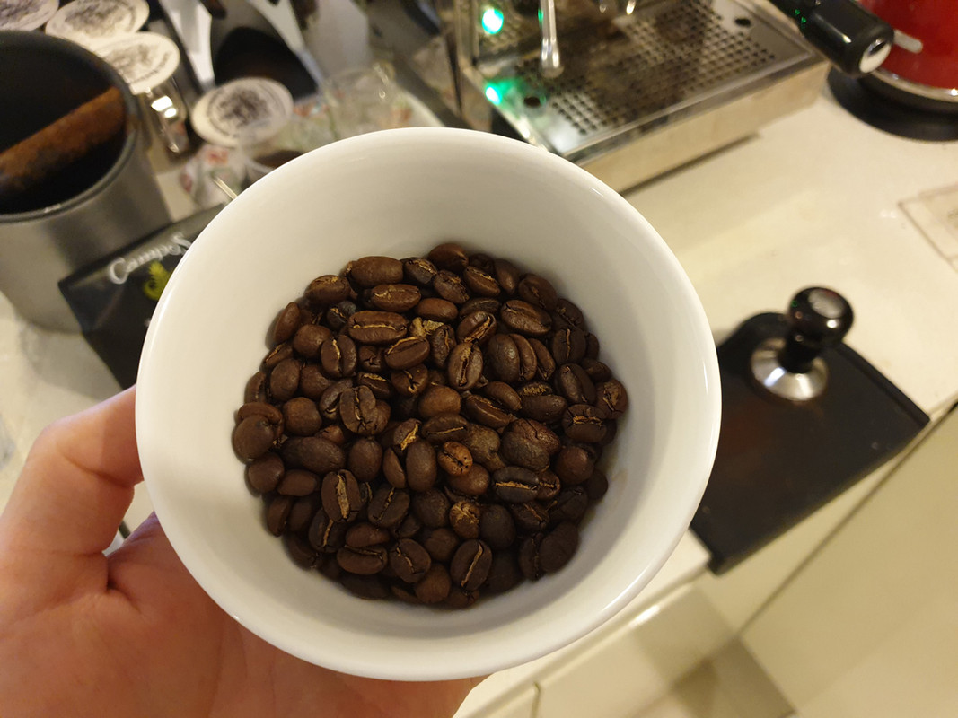

      So I tried a batch barely 3 hours old.
      Way too much crema and 30g espresso took under 20 seconds.
      Taste wise, slightly sour but nowhere near terrible and easily better than the takeaway joint near where I work.

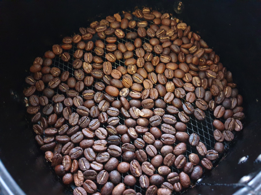

        2nd ever batch, this time the Peru.
        Heard the 1st crack around 8 minutes in. Got so excited I took a video of it!

                I'm using a Kogan air fryer with a rotisserie cage. Works in principal the same way as the gene cafe I'm busting to get my hands on! As a newbie roaster it does the job and we've had some amazing successes and some spectacular fails. I fully expect this to continue for at least another 10kg of green beans regardless of the equipment used to roast.
                Biggest issue I can see with my very limited experience is temp control. The dial is manual not digital so precision is out of the question. The cage rolls very slowly so beans can be unevenly roasted. The amount of air being heated is very large compared to the space the cage takes up so changing temperature doesn't really have an effect. It is awesome being able to see the beans so we have stopped dropping the beans based on time and do so by sight and smell.
                Having said all that it does the job and we've been able to reproduce successful roasts.
