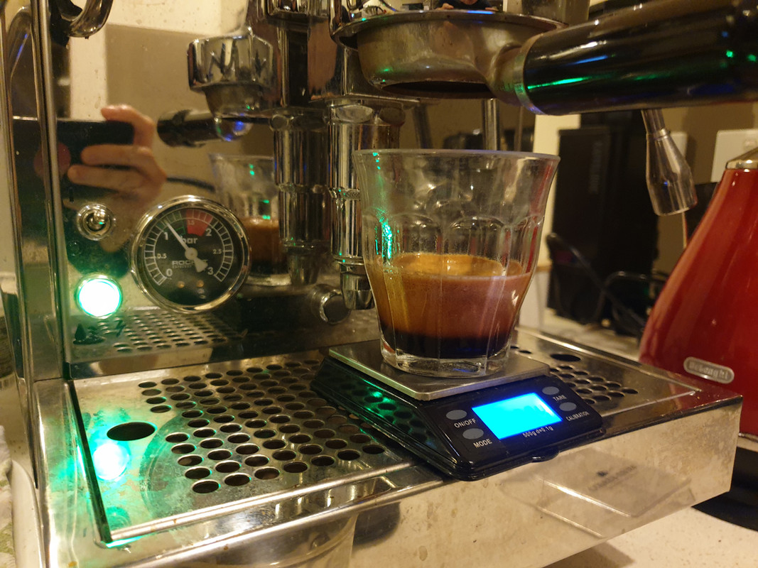

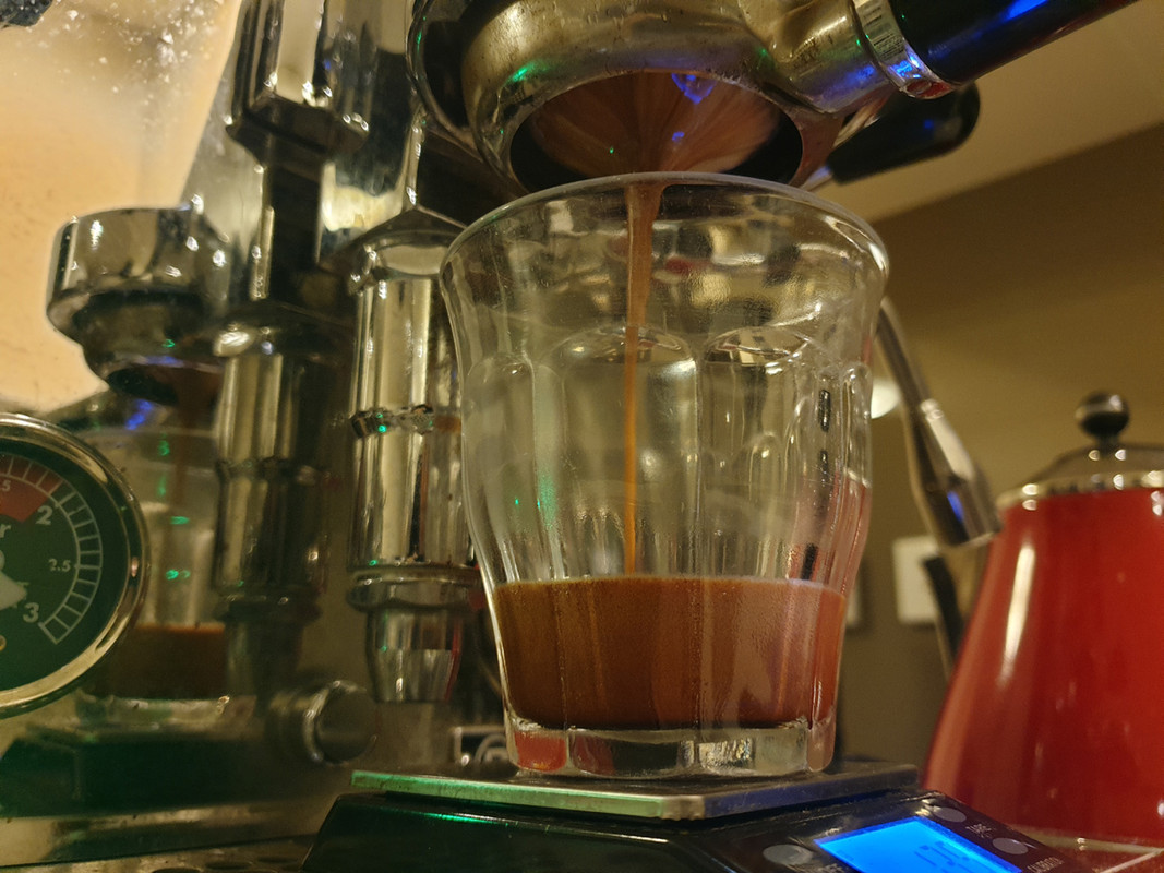

    Hi all.
    Got my Kaffelogic Nano 7 the other day and I've run about 8-9 batches with the Colombian and Peru AAA from Bean Bay.
    I've always heard that you had to 'de-gas' or rest the beans for about 5 days after roasting, as pulling an espresso before that could result in too much CO2 which means too much crema in the cup.
    I'm currently drinking the oldest beans I have, which are 3 days post roasting, and too much crema is what I'm getting.
    The photos below are when I pulled a shot from 1 day old beans. 3 days old now they aren't as bad but still too much crema.
    I'll see what they're like 5-7 days in.
    Would appreciate any help.

              As an aside - I once roasted a bean and after 5 days was still getting significant crema as shown above. I always weigh my shots so thought I was in the right ball park for grind / dose / tamp, as I was 18g in and 40g out in about 25 secs - my typical ratio. I changed my grind a few steps finer with same dose and strangely I got the same brew ratio but with a much thinner layer of crema, and more importantly it tasted better.
