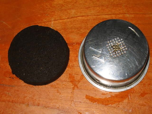

    Hi Ozz. Your mod looks good. From the description, I dont think the problem is with your cafe roma, so I dont think you should rush into selling it just yet. If you are getting a pour time of 13 seconds for 60ml from your single basket, that is the most likely reason for your problem. I think you should be aiming roughly for a pour time of 30 seconds for 30ml from your single basket. You should not try to extract more than 30 ml from a single basket - it will just taste bad. With your current set up, the water is moving through your coffee 4 times too fast. This suggests that your grind is not fine enough (if you are tamping hard) and is probably also connected to the lack of crema. The sunbeam grinder can be tricky to get right and I think if it isnt clean, then compacted coffee grounds can keep the upper burr from getting closer to the lower burr even when you dial it down. So, firstly, try to clean the burrs if they are covered in old grounds. Then, try grinding at a the same or even a finer setting. If you cant get a setting that slows the pour rate, then the problem is with your grinder, not the cafe roma. I used to be able to choke my cafe roma so it wouldnt pour at all, if I dropped the grinder setting to about 10 and tamped hard with the plastic tamper. From there, 1 or 2 clicks higher, same amount of coffee and same tamp pressure, had it working about right, producing nice coffee with decent crema through my modified basket. I dont know Campos coffee, but if it isnt fresh roasted (ie. within a few weeks at most), then that may also be why you arent getting much crema.

    I cut a hole in my basket with a dremel and a tiny cutting wheel. It looks like this
    Note the hole is square and roughly 5mmx5mm. It made a significant difference in the flavour in my opinion. It also prevented the annoying blockages I occasionally had. It basically means that the basket itself doesnt provide the resistance, the coffee does instead, hence the extraction works in more or less the same way as in a commercial machine. You can also get away with a finer grind and harder tamping with a modified basket, whereas the pressurised baskets block too easily if the grind is fine.
    An alternative is to order the krups non-pressurised basket, which is mentioned many times in the thread I listed here.

    I used to get this too before I cut a hole in the bottom wall to make it a non-pressurised basket. I dont think you can really get a nice dry puck with a pressurised basket.

    The water on the puck thing is probably a result of the pressurised basket that come standard with the cafe roma - I used to get this too before I cut a hole in the bottom wall to make it a non-pressurised basket. I dont think you can really get a nice dry puck with a pressurised basket. That said, I reckon you will get a big improvement simply by working out where your grinder should be set to give you the right (caster sugar like) consistency and limiting your pour to about 60ml which (as others have said) should take roughly 30 seconds if the grind is right (with the double basket). If you really like a big mug of (strong) coffee, you may have to pour two doubles into the mug. The baskets on the roma are quite small, and you can only stretch the coffee so far, but with overdosing etc you may get enough out of one basket to keep you happy.
