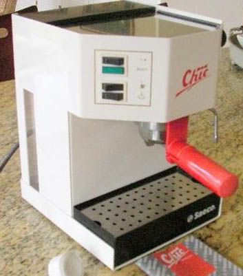

    I recently bought a Saeco chic machine for interests sake more than anything. Since I took a very short road up to the commercial Carimali Uno machine Im using at the moment, I felt like playing with some lower end equipment again ( I regret selling my Krups Vivo ). And looking at them from a perspective of greater experience.
    Initial impressions: Non-pressurized portafilter! And not a cheap aluminium filter holder either, solid chromed brass!
    Upon first popping the hood I was pleasantly greeted with a familiar yet unexpected golden glow...

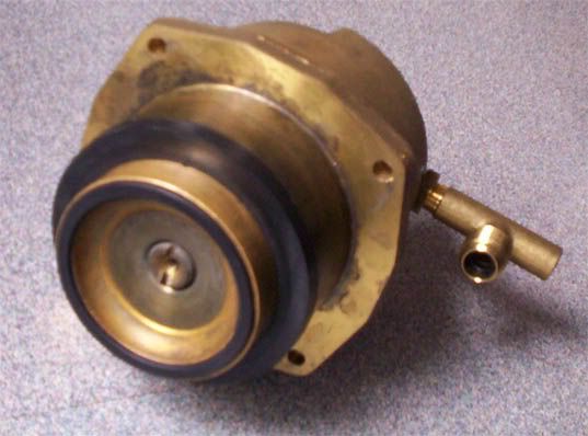

    Yes, this machine has a brass boiler! I was actually quite taken by this, I thought all Saecos had stainless boilers. I tested the capacity of the boiler today and it was around 250mL. Obviously in operation it wont be filled to the max. level but this is still impressive for such a small machine. The pump is a standard ULKA, 52W if I recall correctly.
    One thing that bugged me was the shape of the group, as you can see in the image below it is concave and fitted with a gasket for brewing pods. I pulled the boiler out to see if this was in any way removable, but sadly it seems to be permanently affixed to the lower half the boiler

    looks remarkably similar to silvias insides that boiler on a quick glance!
      Re: Inside a Saeco Chic - brass!
      Probably a generic unit used by several manufacturers Id say Sullo.... Looks to be a very close fit or maybe a bit smaller for the boilers found in Imat Mokita/Quaha Junior/Fenice style of machine....

          The internals and their layout look almost identical to a "Spidem Cappuccino Express" I bought for cheap a couple of years ago. The steam power was pretty damn good from what I can remember. It was a really solid (and heavy) little unit too!
          Ive seen it somewhere else on CS, possibly CG, badged as yet another brand.

            PF is the stardard size for a Saeco, basket measures 60mm from outer edge to outer edge, about 53mm between the inner edges. I did some research and did find a couple of references to brass boilers for old Saeco machines. I think that the name Chic may be an NZ only thing, but Im quite positive this Saeco machine did appear under different aliases overseas.
            The machine of course does have a shower screen, it fits in over the darker area around the boiler outlet valve which can be seen in the photo showing the bottom of the boiler.
            Thanks also for your input Paul, it does seem that Spidem and Saeco sell the same machines.
              Its smaller that the Quaha boiler by the looks of it. And certainly the group side is a different design.
