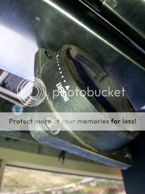

    I recently repaired a cafe roma with similar symptoms. The guy i bought it from said he replaced the group seal with no luck. Being that there's only really two variables, or things that can perish/wear when the group handle is locked in it has to be one of them.
    One is the group seal, the other is the locking collar. Below is a photo of the damage that the machine i had sustained:
    As you can see, the collar itself has developed a split. When pressure is built up behind it, the split widens and as a result the group handle loses firm contact with the group seal. A replacement collar was available from ebay however the listing isn't active anymore. You can get it from BigWarehouse Spares, part number 1649847. It's about $25.
    Check first and see if you can find some damage to the collar on your machine, i imagine there will be a weakness in it somewhere. If it doesn't look like its damaged then the plastic guides that push the group handle up onto the seal may be worn and not supplying enough pressure. If so, the collar will need to be replaced anyway.
