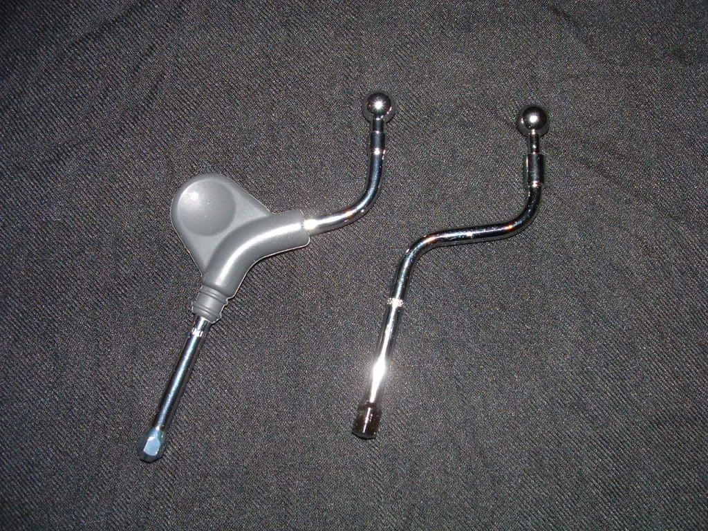

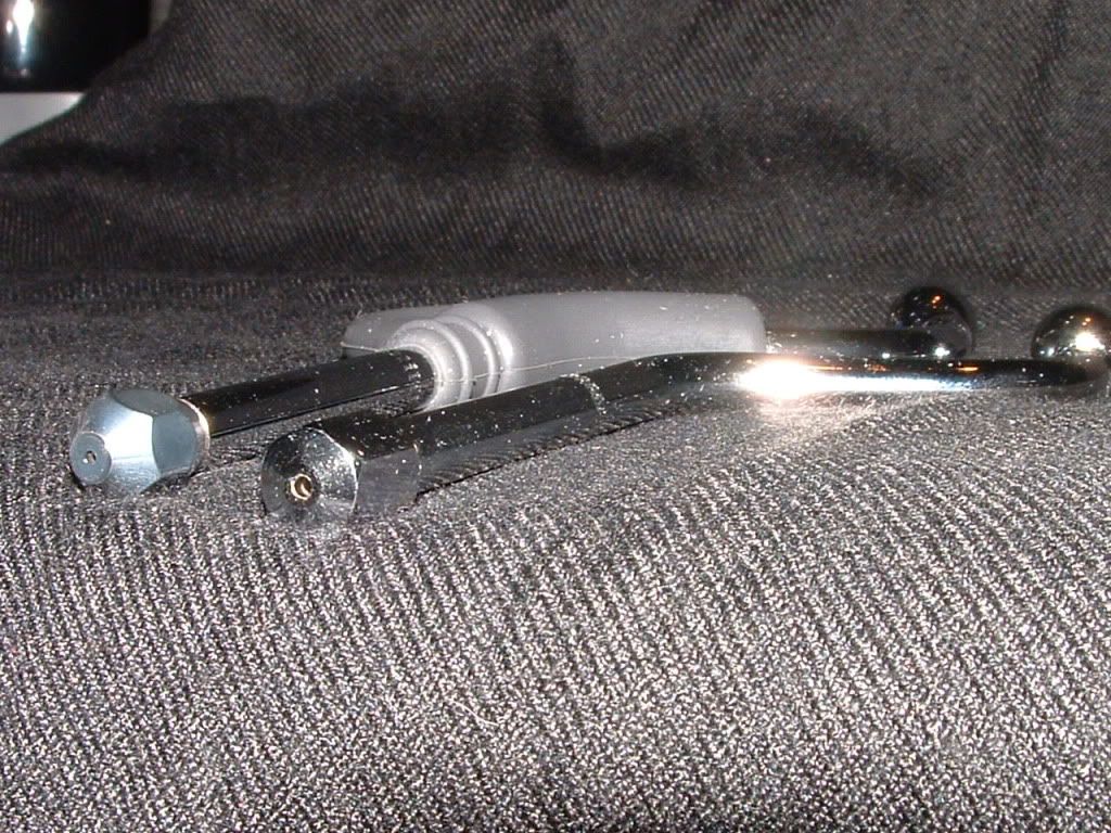

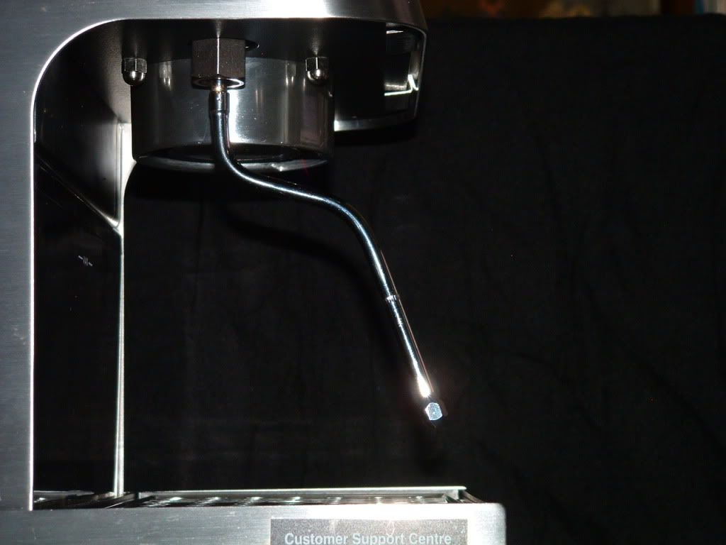

    I tried the Breville 800ES steam wand and it does fit the Saeco Via Venezia. It is a little longer than the Starbucks Barista steam wand. Using a small jug I found it comfortable to steam out front of the machine whereas with the Starbucks wand I found myself at a diagonal to the left of the machine and feeling a little close when steaming for 1 cup. The Breville wand tip has a smaller hole which increases steam pressure. I found the whirpool effect alot stronger at the same steam setting and milk stretching quicker. Ive only tried it once but I found it overfrothed quickly, which I guess reflected a need to become familiar with this wand and the increase in steam pressure. Milk temperature came up quicker at the same steam setting and interestingly, the light on the steam button stayed on throughout the process. Using the Starbucks wand I found the steam light went out but it did complete the steaming process. My machine is 1 y.o. so the heating element may not behave the same as a new one would. I have no idea how the previous owner treated it before I bought it. The smaller hole in the steam tip of the Breville increases pressure both in steam coming out of the tip as well as back-pressure for steam out of the boiler. I imagine the steam light staying on with the Breville reflects a smaller volume of steam but at a higher pressure.
    At this early stage my thoughts are that either one would do the job. It would come down to how easily and cheaply either one could be sourced. I feel the Starbucks wand is more forgiving as far as overfrothing goes. The Brevilles extra length is handy to have and the extra steam pressure probably not a bad thing once mastered but I am yet to verify this. If I had to choose I would say I do like the extra length of the Breville wand but need to use it more to see if the extra steam pressure has the benefit I suspect it might. The Starbucks Barista (rebadged Via Venezia) wand was supplied standard with that machine so I guess designed for it. Pricewise the Breville and Starbucks are similar but there is that hefty shipping charge for the Starbucks wand from Canada. With either wand I would suggest to replace the 2 half-seats for the ball end including the washer above the top seat.
    Please note I dont know what the longer term effects, if any, will be on the machine by fitting these steam wands so be aware that if you choose to fit them it is at your own risk! Do remember to prime (fill) the boiler before and after steaming to protect the health of your machine.
    P.S. After using the Breville wand a few more times I found  it did seem to produce velvety microfoam much easier than with the Starbucks Barista wand (on my machine). If the Breville tip was kept just below the surface and not allowed to introduce excess air, (which would happen quickly if the tip raised above the surface) and with the whirlpool generated correctly, the result was excellent microfoam.
    With the Starbucks wand on my machine, I needed to work the wand alot more and didnt achieve the same velvety microfoam. Might be my technique, lower steam pressure than new machine, type of milk? Either way I have left the Breville wand on my machine as it seems to do the job easier for me. The steam tips are interchangable between the 2 wands. The Breville came with a silicon washer whereas the Starbucks didnt. When I removed the Starbucks tip after only a few weeks use it was very tight and I thought maybe loctite had been used. After closer inspection I think it was baked on milk that had crept up the threads due to a lack of a washer between the tip and wand. I reassembled using food grade silicon grease just in case.  :
    Below are some photos comparing the 2 wands :-
    Breville 800ES wand on left includes safety grip which can be bought seperately. Starbucks Barista wand on right.
    Smaller hole in Breville 800ES steam tip at left.

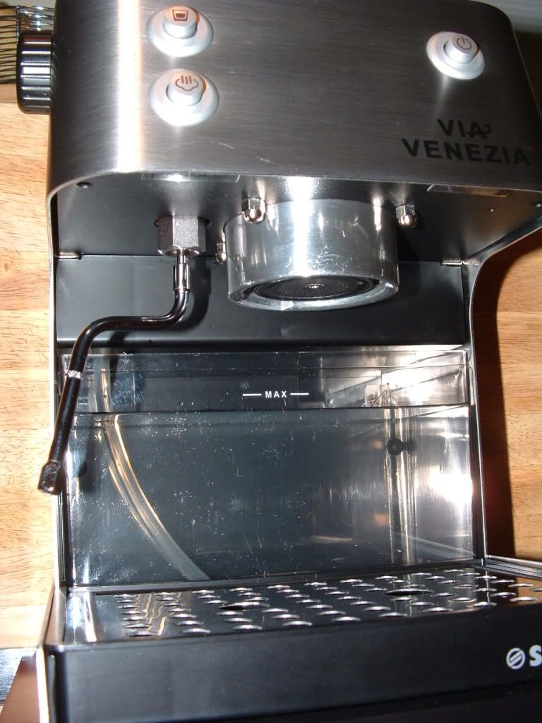

    Starbucks Barista wand fitted to Saeco Via Venezia
    Breville 800ES wand fitted to Saeco Via Venezia

    After lots of searching I discovered that the Steam Wand from the USA sold Starbucks Barista coffee machine (rebadged Via Venezia) fits the Saeco perfectly
    I can now post photos so here is one of the Starbucks Barista Steam Wand on the Saeco Via Venezia. Works a treat! Movement is in all directions as per the original Saeco steam arm with Panarello which was fitted to this model as standard.
