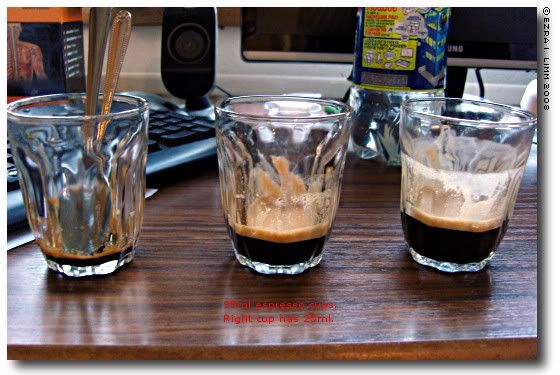

    Once upon a time, i thought that I my espresso making ritual was consistent enough.
    Left: 25s pour. 20kg tamp. ~5ml. Grinder at reference point. <-- Far overextracted. Bitter. Undrinkable.
    Middle: 10s pour. 20kg tamp. ~15ml. Grinder +1 click.  <-- Underextracted. Sour and acrid.
    Right: 10s pour. 20kg tamp. ~25ml! Grinder at reference point. <-- VERY underextracted.
    The results dont make sense. The first pour was way overextracted. So i set my grinder one step courser. The pour time to blonding for 15ml was 10s. It was a gusher and was way underextracted. So i set my grinder back one step finer. To my surprise, the time to blonding was still  about 10s, but this time, 25ml had gushed through!!!

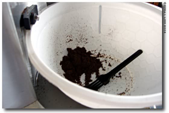

    If you are like me, and only take about two coffees a day. The grinds stuck to the insides of your grinder could make a big difference in your shot. The picture above shows the amount of ground coffee stuck inside the grinder. They were dislodged by rocking the grinder back and fourth - the vibration from its rubber feet stomping let out more than two teaspoons of grounds. Also, if left overnight it will go acrid and your coffee the next day would be sour.
    TIP #1: ALWAYS remove stuck grounds from your grinder when changing your grind settings / or after you are done using your grinder.

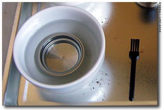

      Part Three: Important Care Tip For Pressurized Baskets
      This was THE reason why the three shots in part one varied so widely. Im sure many others have faced this problem with pressurized filter baskets and subsequently (and rightfully so) thought that pressurized filter baskets are crap. Some grinds ALWAYS get past the first layer of your filter basket and get trapped in the tight pressurized layer between the pinhole and the top part. Your filter basket may be partially stuck, generating far more pressure than what your machine was designed for. This results in a slow dark bitter shot. You then try to repeat it with a courser grind, but this time some particles dislodge and you get a gusher.
      Therefore, it is ABSOLUTELY ESSENTIAL to look after your pressurized basket properly. As a rough guide, if you have been taking good care of them, fill them halfway with water and press on the top with your palm to generate an airtight seal and a little pressure. With minimal pressure you should see water spurting out from the pinhole at the bottom. If water just drips out, your basket is partially stuck. If no water seems to come out, your basket needs to be flushed.
      TIP 4: Treat your pressurized filter basket the way you would treat your retainers/dentures. Flush them after each use. Leave them soaked in water. Flush before each use. It helps warm up the portafilter as well when you do that.
