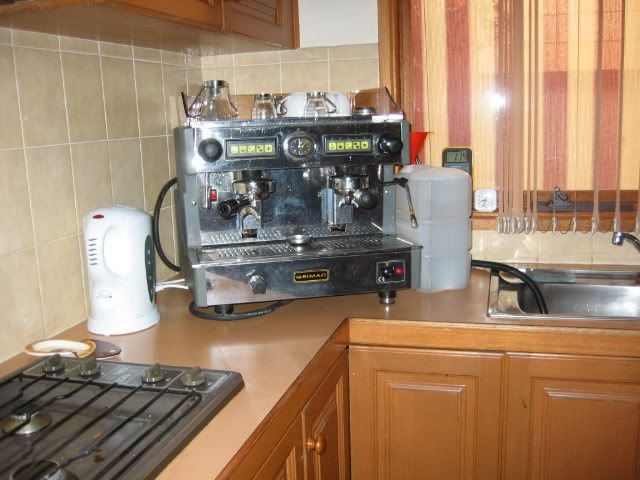

  • robusto
    Re: Upgraditis: 2-group Grimac Commercial
    I guess JavaB that 100 years ago architects paint scant regard to the  problems of where to place the La Cimbali.         And ditto 20, 10, 5 years ago.   >
    The situation is beginning to change ever so slightly now.
    We have a large kitchen but the layout has never appealed -- broken up bench spaces.  Were thinking of  rearranging it.
    Between the sink and the pantry sits the fridge.  To me, that reads "ideal place for coffee machine and grinder."  Problem is where to put the fridge.
    (Do we really need a fridge? Cant store coffee beans in it)
    -Robusto
  • JavaB
    Robusto,
    Looks really "at home" there.....
    Once plumbed in you can loose the water container - and no need for the electric kettle when you have boiling water on tap...... So should look really neat and be a real asset to the kitchen.
    My two group fits snugly into an alcove - there was an old wood stove installed in that space - (the house is > 100 years old).... the stove was removed some time ago, a cupboard unit was installed below and the microwave sat on the shelf... and is there no more....
    Unlike your installation, it was a PITA to get plumbing and power to the location (the alcove is all brick with a concrete slab - because of the heat from the old stove).
    Very similar positioning to mine.
    Except I dont have a 2nd group taking up the extra space I use for all my coffee paraphernalia.
    If the overhead cupboard hadnt looked slightly different I was about to check that you werent in my kitchen.
  • wattgn
    Looks very nice. His and Hers groups
  • robusto
    Location...location....location.
    Even before the Grimac 2-group arrived, we anticipated locating it in the kitchen corner between the hotplates and the sink. Handy to power, water and drip tray waste disposal.
    But the breakfast bar opposite was much more roomier, and thats where the machine has remained, complete with temporary water tank.
    Now its edged closer to its destined position.
    Well trial it there before taking the hole saw to the benchtop and later  perhaps changing our minds.
    Plumbing in will be a breeze -- Under the sink theres a hot and a cold water tap for the dishwasher.  Only the hot has been utilised, leaving the cold tap ready to screw the Grimacs water hose into --- via a softenener cartridge, of coure.
