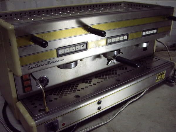

    Another extreme machine to introduce:
    I couldnt resist this for $207.50. Now, all we need to do is build a house that will fit this!

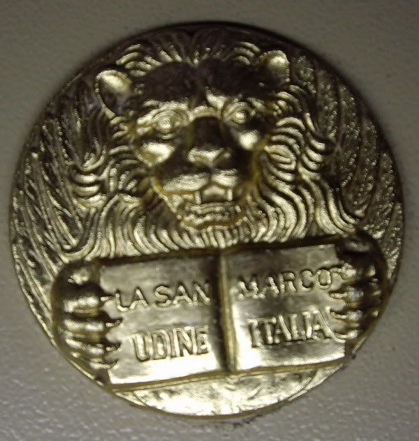

    The LSM Logo:
    The Machine:

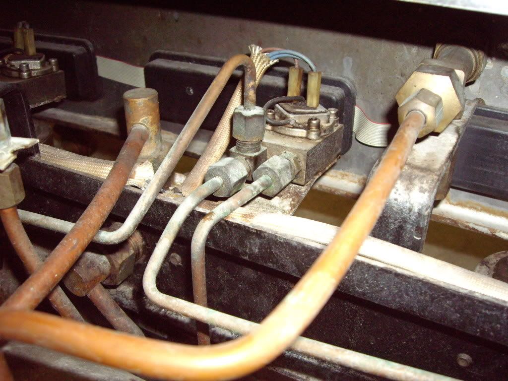

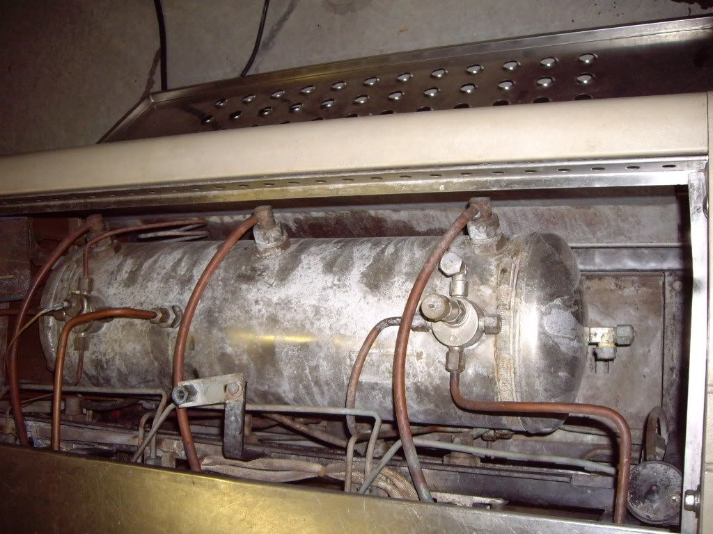

    Her Boiler:
    And a little more:

        I came across this at the place whose name shall not be mentioned. The guy who owned it is an electrician and got her from a cafe in oxford st about a year ago. Its been sitting on his kitchen bench ever since and he said he has used it about once a month since then - plugging it into the 15amp (the plug is showing signs of melting).
        Anyway, he said he just wanted to get rid of clutter. I bought it without inspecting it first and couldnt believe my eyes this evening when I took the cup-warming tray off. After some of the pics Ive seen on CS, this seemed to look new inside. I couldnt get it out of there fast enough! Funny thing is, the guy I bought this from has offered to buy the bike I havent started to restore. If I accept his offer the LSM will have cost me $100 to date.
        Build date is 22/10/1992 and pulls a massive 5000watts. I think the boiler capacitty is 19litres and the whole unit weighs oooh, maybe 80kilos.
        Ill need a lot of help from you guys to restore her. As mentioned earlier, there is no way she will fit in our kitchen, and the giotto looks so good there anyway. We live in a rahter large townhouse and fortunate enought to have a storeroom/workshop downstairs that is almost the size of a single garage. Eventually, I think she (have to give hre a name) will probably live there...and I think Ill be spending a lot more time there too.
        Oh, and heres the best bit - its made in Italy!

          5kv. That is serious: 20+ amps. I dont suppose you have 3-phase power to your storeroom? Might be worth considering on the presumption LSM can take it.
          Perhaps you can do what Sparky did to his La Pavona, and run only part of the element to cut down on current draw. If so, at least you may be able to give her a test run without rewiring your house to nuclear auxiliary.
          Otherwise, at the very least youll need a dedicated 240V 20-amp line back to your meter box.
          As you say, the under the bonnet condition looks pretty good -- maybe youll get away with just a good scrub and one or two minor part replacements. Fingers crossed.

                  I would have paid almost that much just for the badge.

                            Very clean looking inside.
                            A definite bargain Dennis.

                              It is almost certainly a 3 element 1600W per element machine.....
                              Except for the 1 hour or so walm up you could probably run just one element (on 10 A supply or two 3200W on a 15 A supply (thats the "standard" element configuration on my La Cimbali - 4000W in total - for single phase power) - takes about 35-40 minutes to walm up.... I wired mine for MAX power so 20A run!
                              Or You will need a 25 A run (to allow for surges etc) if you intend to run all 3 elements....... in which case warm up will be about 20 minutes. - and there is always 3 phase if you have it available.
                              Warm up is time for the boiler to get to pressure...... Mine takes about 20+ more minutes for everything to stabilise before making espressos.
                              Looks to be in great condition as well. Good buy!.
