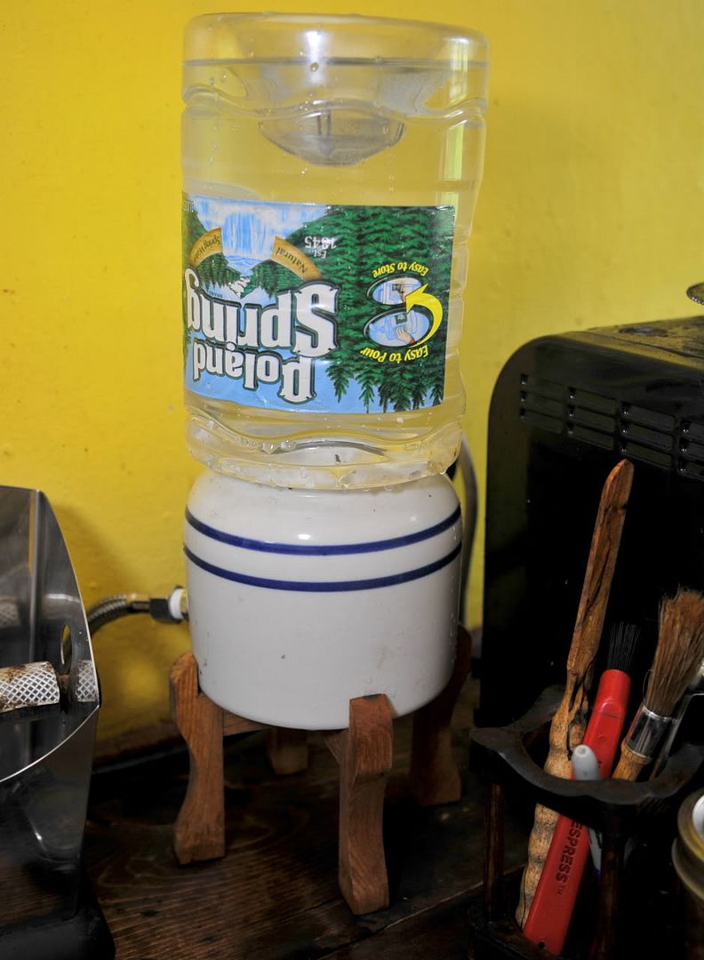

    Im more interested in his water reservoir set up. How did you do it? What kind of water bottle did you use? [/QUOTE]
    David,
    fairly simple, its a ceramic bowl with some modification in the fitting, and a 1 gallon Spring water.
    for the fitting I use a rubber leg of a Livia90, shaped to fit in the bowl and a hole in the middle for the fitting
    straight to the rotary pump
    thats the set up
    it works great.!

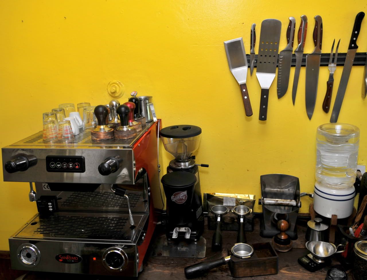

    I still want ya Group Handles and Tamp stand and Tamp box..
    What Timber is that ?
    AM
