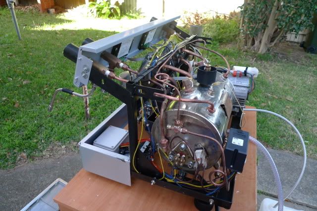

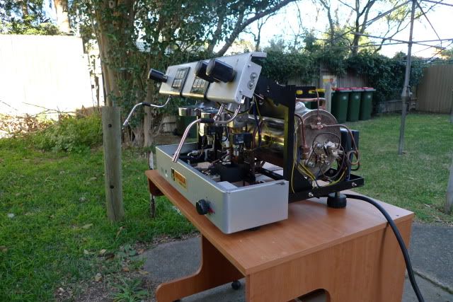

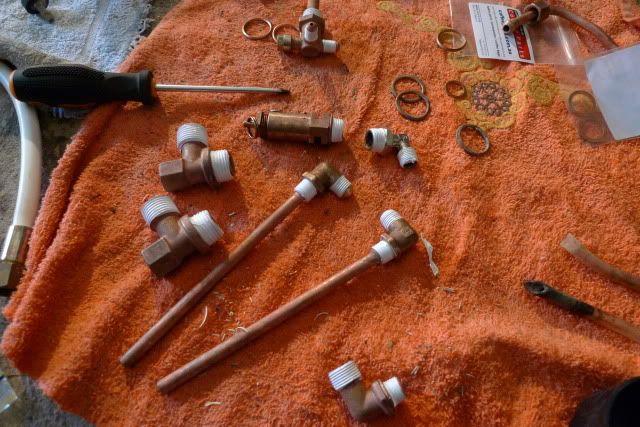

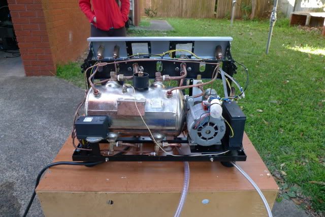

            • #21
              Re: Brasilia Portofino 2 Group
              Well, we have made progress!
              Things slowly got put back together, and after a few rolls of thread tape and a bit of a jigsaw puzzle, Lazarus was back together! Unfortunately, the cleaning process wasnt as successful as Sootys, it has still come up ok.
              So, I switched it on and all was ok. 1 leak which was fixed in an instant. But then, as soon as the boiler reached pressure - we had a mega leak. As I mentioned earlier, I had to get a copper pipe made up. Now, I will name and shame this company - Pirtek did a HORRIBLE job. I complained at the time of pickup and managed to get a significant discount because of the poor quality of the job. I thought I could get away with it however, because it seemed mostly aesthetic - how horribly wrong I was. So, I will endeavour to get the pipe replaced ASAP and hopefully well be in business!
              I have one small problem - the valve for the water wand is squealing on opening and I am guessing that its simply a lack of grease. But I cant open the body of the valve to re-grease it. So, what do I do? Can I still manage to get some form of lubrication in there? Any ideas?
              Ben
                          Regarding the replacement copper pipe Ben,
                          Id give the job to a decent plumber/gas-fitter or a refrigeration mechanic. These guys work with this stuff all the time and should be able to do a good job for you
                          • #28
                            Thanks for the advice Mal.
                            In hind sight, I probably should have done exactly what you said. Today I took the pipes back to Pirtek in the hope that all will be fixed and we will be up and running again soon.
                            Hope everyone is enjoying the photos.
                            Ben
