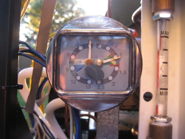

              So I eventually got the pipes back, but yet again they were not to specification. This time, however, there were no leaks. Just the pipe from the boiler to the group head is too low and as such the machine needed to be propped up - easy fix with a larger set of legs from Coffee Parts soon.
              Machine is currently running on 10amp power with one boiler element disconnected. As such it takes a while to get up to pressure but that is expected. It is reaching a lovely 1.1 bar, with excellent steam pressure (almost blew my socks off!!)
              The problem now, I believe, is the rotary pump. Under the load, the group head pressure is reading under 2 bar, which is well below the required 9 bar. The motor is definitely turning, and the autofil detection is working and switches on the motor. But the pump does not fill the boiler, and the flow at the group heads is definitely restricted.

                          Thanks to Maheel (big thanks), I was able to test with a working pump. Once we got over a sticky pressure gauge, the left group came up to a beautiful 9 bar. The right group didnt get past 3 bar so perhaps there is a blockage in the group - Ill hopefully take it apart this weekend.
