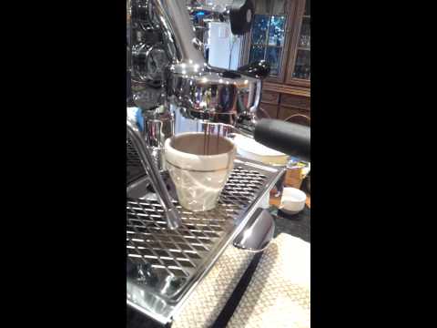

              Hi Pete,
              I know you mentioned something clicked last weekend, and you were doing a better job with texturing milk on your duetto.
              But here's that video of the coffee I just did. Approx 100ml of milk in 400ml jug, with an attempt at latte art into a 160cc tulip ACF cup. I ran a teaspoon across the top layer (not too sure if this achieved much), and you'll just have to take my word that the microfoam turned out well; the top layer's pretty creamy, no bubbles and is probably 1cm deep.
              Youtube clip should be finished uploading in another hour or so. If the link isn't working, i'll fix it up later.
              • Specialpants at 1.08 in the video it looks like you get a squirt of coffee on the far side of the cup. I was wondering if that was coming from out of the top and far side of the portafilter, like the group head seal is starting to wear a bit. Maybe I am seeing something that isnt there, but I had mine start doing a similar thing and it was time to change the seal in the group head.
                • You would be correct about the squirt. I get that every now and then when i use a naked handle, where a jet of water comes out of just one hole in the basket and sprays either the cup, drip tray or the coffee machine itself.
                  • Originally posted by specialpants View Post
                    Yes- that's called edge channelling. It's a dose/distribution issue, not the machinery. I feel that the holes right to the edge of these baskets makes them more prone to is if your distribution is not perfect and without a very well fitted tamper.
