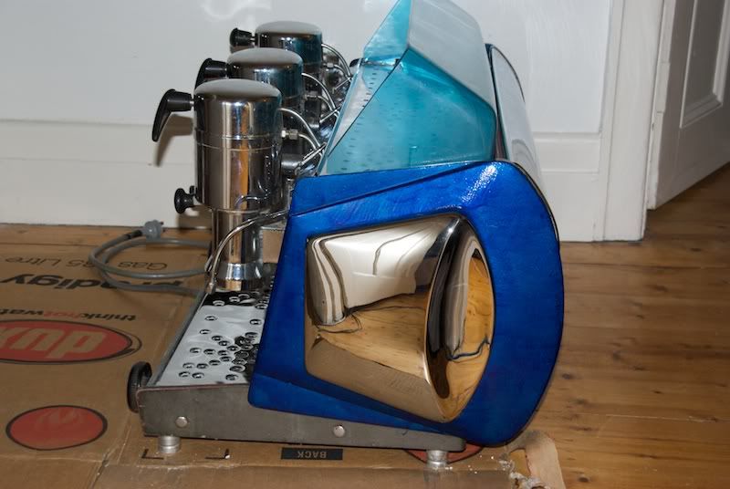

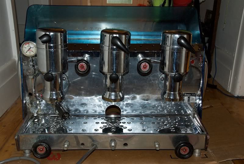

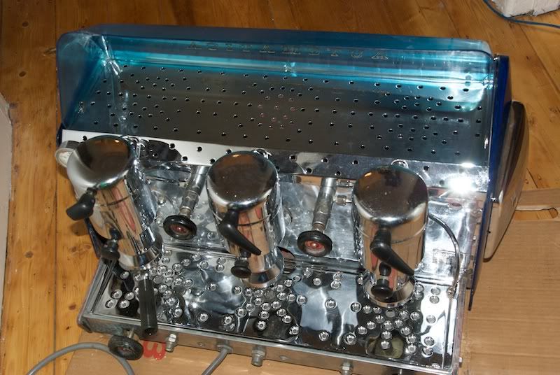

  • simonmelb
    Re: La Dorio Atlas Automatica 1960 (ish)
    Hi Leeham
    I hope the following photos will help and inspire you.
    This is my machine, which is being looked after by a friend, while I complete the restoration of my La San Marco and build up my restoration skills. Ive been keeping this quiet as I have promised the previous owner he would be the first to see it when its running!
    But now I have a duty to help a fellow Coffeesnob, so Im happy to provide you with all the info I can to help get yours running.
    You can see the design of the top levers, and also the perspex hood. I dont have the original group handles. Everything else appears to be original and complete.
    My machine is around 1964 I believe and still has the serial number plate as well as the Australian importer plate. According to the previous owner it came from a cafe in Ascot Vale, Melb and has not been running for quite some time.
    As you can see the drip tray, sides, top and top front trim have been re-chromed. All the rest is untouched. I plan to conserve as much or the original patina as possible and will most likely leave the existing boiler insulation in place as well.
    Please let me know what other pics youd like.
