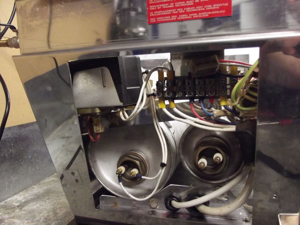

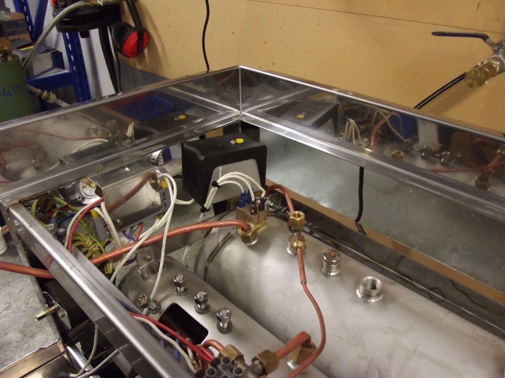

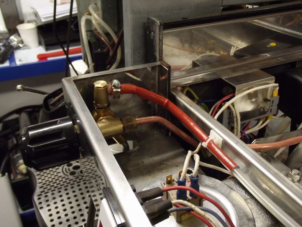

    Yeah they are wired correct , that pic is before I made up some new wires to go to the element.
    The new wand kits come with the hose, t pieces , cable ties and stick on mounts so very easy to make it neat.
  • coffee_machinist
    Ah I didn't realise it was an EE! Love how you've plumbed in the steam anti-vac lines, very neat.
    You might want to check the connections on the brew thermal cutout, from memory the switched connection is across the long side. But it's obviously heating, so there you go.

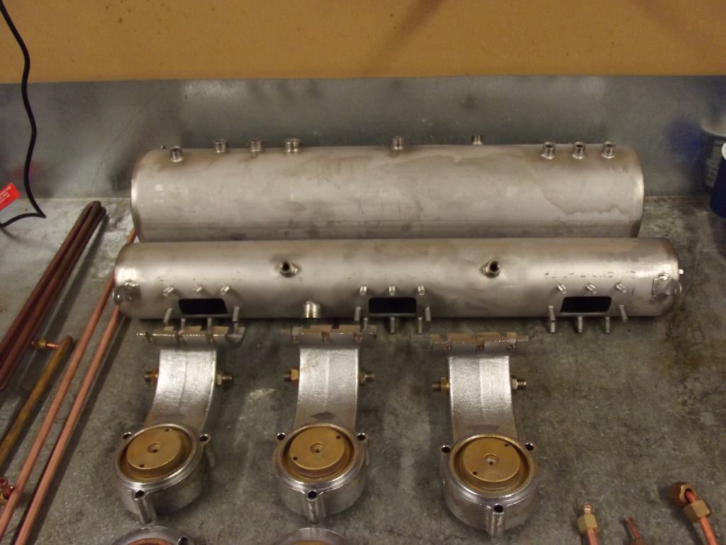

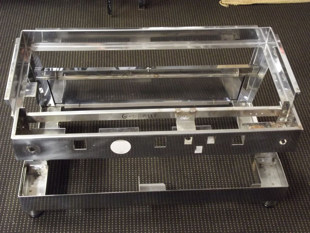

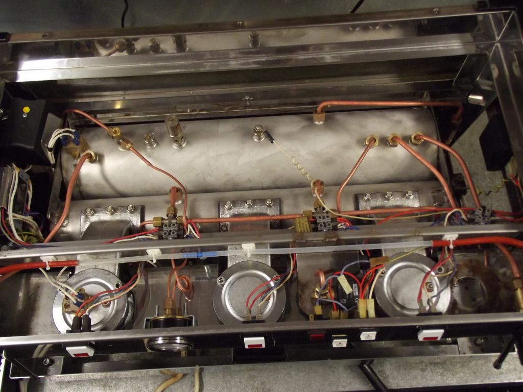

    Update , got the boilers and pipework back from cleaning today so started putting it back together.
    Nice clean frame.
    Freshly cleaned and descaled boilers

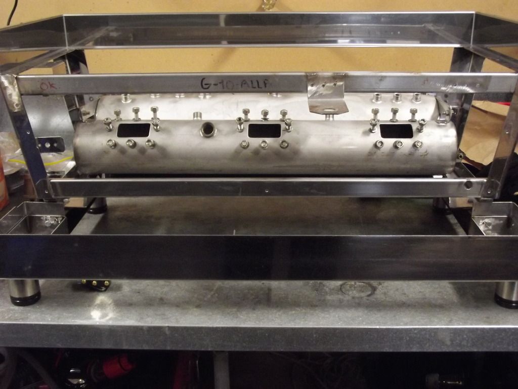

    Boilers bolted in on modified mountiing points to give slightly more cup height.

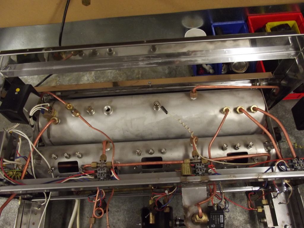

    Getting there , new terminal blocks.
    Just waiting on group manifold gaskets then they can go on and be plumbed.
    Thermostats , valves , steam taps , switches ect. are all new. Only reusing solenoid valves as they are still good condition.
    Hot Water outlet has been relocated between groups 2 & 3 as the customer didn't like it so close to the R/H wand.
