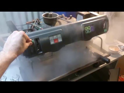

  • greencardigan
    I've been getting some really excellent extractions from this machine! I'm using the single basket from my Breville BES920 with my usual grind and dosage but the Faema extraction seems a step up from the BES920.
    I'm still mesmerised by the steam volume! Anything I can do to make it more manageable?
  • sprezzatura
    Try your spacer; it may work.
  • sprezzatura
    OPV may drip anyway. Thermal expansion of water in circuit. Don't worry about it if you're getting your 9 bar at group. Steam. Always a hassle with this style valve. Occasionally reseating the brass part of the seal area allows the gasket to seat completely. It's annoying but can be lived with.

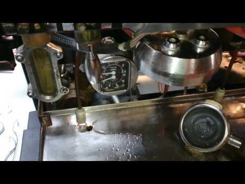

  • greencardigan
    I've replaced the 3-way valve seals, and group head jet seals and have connected everything back up to test.
    No leaks, and more importantly, 9 bar pump pressure! Although I'm getting 9 bar with and without the blind filter. Is that normal?
    Pump pressure with and without blind filter
    Also when the boiler auto fill is running it's showing 8 bar. Seems a bit high?
    Next step is to get the boiler up to temp again to check the repaired leaky steam valve. Getting close to a fully functioning machine.
