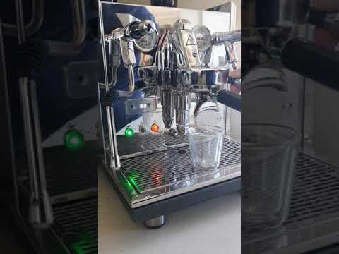

                        • I finally retired my 20 year old Bezzera BZ99 after the Procon pump siezed the other day and picked up a Synchronika today from Prosumer. Thanks Lance and Steve. One afternoon thinking about it, next day pouring shots with it.
                          I chose this machine for a few reasons:
                          • Rotary - after modding the BZ99 to a rotary, I could never go back to vibe.
                          • DB - I didn't mind HX, but I only have 1 milk drink a day and around 4-5 espressos, so always felt it was a waste of power to heat a larger boiler to a much higher temp than needed.
                          • Insulated boilers - the BZ99 was kept on 18 hours/day, costing about $400/yr in power. Planning on turning this one on only when needed to make it not so easy to have 5-6 coffees a day. Wanted insulated boilers to reduce the wait, and not heat up the kitchen so much.
                          • Switchable tank/rotary - was a pain to descale the BZ once I'd converted it to an external under sink rotary.
                          • Nondescript PID display - not a fan of electronic displays on a piece of art and I think ECM must not be either for them to make the display so unobtrusive and even allow the digits to be turned off.
                          • Overall design - Rockets I found too much branding for my taste. Profitecs didn't do it for me. Definitely fond of Bezzera brand after the BZ99 just was so reliable, but the display the DB's have on them is not my cup of tea. I get a bit OCD about design, to the degree that the font used on the gauges of the Synchronika nearly turned me off it.
                          Click image for larger version  Name:	Sync.jpg Views:	0 Size:	305.7 ** ID:	850137
                          Upon unboxing - flawless panels, and I went over them like the staff when you return a rental car.
                          Quite a big machine - noticeably larger than the Technika V Profi next to it at the showroom. I do have ample room under the cupboards for cups, but the tank is quite deep and I'd have to either slide the unit out to remove or fill with a jug. I will be connecting to the filtered line used by my old machine when everything appears to be working well, so not a problem.
                          I have it paired with a Sette 270, but must say the Sette 270 is now punching above its weight. It looks totally outclassed. First world problems.
                          Tried the Witham's Mocha blend they gave me with the machine - first two shots ran too fast and got banished to the sink, third ran well but sloppy puck. It's my first E61 though and I learnt I wasn't putting the brew lever all the way down to activate the 3 way (or whatever the E61's version of that is).
                          Drinkable with milk though - maybe a 6 out of 10.
                          Click image for larger version  Name:	firstcoffee.jpg Views:	0 Size:	66.6 ** ID:	850133
                          Weighed next dose and noted it was only 15.5g in a double. Coarsened it up a little, upped to 20g, a bit slow, not sloppy puck but quite spongey and lots of residue on the basket walls when tapped out.
                          Went down to the single basket which on the Bezzera I found hard not to get channeling. Surprisingly much easier with the Sync, but still lots of work to do. Decent looking pour, definitely not thin so suspect no major channelling, but shots haven't been good yet. Feel a bit blind without a naked. Maybe I'm just used to my pucks coming out clean like biscuits with the basket requiring no more than a drying wipe between shots. Not used to doing so much basket cleaning! Lots of experimenting and reading up on E61 to do. Prosumer/Withams chuck in a home barista course so I'll do that soon too.
                          Steam: wasn't as powerful as I thought it might be at stock temp, but totally nailed the milk first go which I never do on a foreign machine and even rarely on the BZ99. Was the two hole tip - no four hole tip as Ecm2020 mentioned above. I'd forgotten how silky milk can be.
                          Pumped it up to 132° and that's more like it. Nailed the milk again despite only being 150 mL. It's a damn good steam wand/tip - very impressed. It's nice that the steam lever isn't on/off but can come on slower to get started. I was a bit concerned I'd miss the precision of a knob but far prefer the lever given that it shuts off instantly.
                          More condensation in the steam wand than I'm used to, but it's my first cool-touch wand. Might eventually rip out the teflon tube inside or whatever they're using as the anti-burn sleeve is adequate for control.
                          Will run it on tank for a week to ensure all is good, then swap to the filtered line. Looking forward to running a drain line as well which I've never had before.
                          Question: the manual states the T1 temperature displayed is the coffee boiler temperature, which shows 93°C from factory. I did a crude check with a k-type in showerscreen stream and was seeing around 91°C which sounds fine. But the configured E1 offset value is 15°C - so confused as wouldn't that imply 78°C brew?

                            Glad you’re having fun playing and glad we could help. Once you nail that extraction on the Super Mocha blend, it should be nice and chocolatey (hence the name) and hopefully will score a bit higher than a 6/10
                            As for the offset, the temp in the brew boiler is always higher than the temp at the group and the PID takes the temp reading from the boiler rather than the group but it’s much more useful to have the group temp displayed, which is where the offset comes in. So with the offset set at 15°C and the display reading 93°C, it means the temp of the water at the group is 93°C and the temp in the brew boiler itself is 15°C higher (i.e. 108°C).
