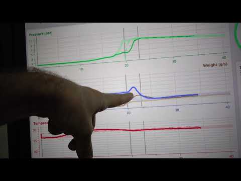

                              • Dialing in your grind
                                Today I posted a video about dialing your grind in. I find this is something a lot of people new to home espresso making struggle with.
                                I tried to keep this simple width:
                                1) what it looks like when you have too fine a grind
                                2) what it looks like when you have too coarse a grind
                                3) how to make small adjustments in flow by varying your dose instead of changing the grind
                                4) how to read the decent espresso charts to try to understand how you should change your grind or dose
                                Would love feedback on how you think I could help people dial their grinding easier or faster.
