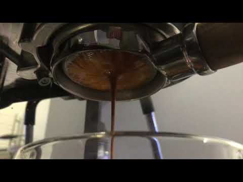

                        • A very high yield ratio shot with Decent Espresso
                          4 way blend of beans from BeanBay
                          • DamianB thank you for posting that, nice to see a CS poster posting about their DE. What is the brown line in the graph? Great photography!
                            • Thanks 338,
                              Brown is weight in the cup in grams, you can connect a bluetooth scale to the DE and graph the weight, you can also set a "stop at weight" value to end the shot
                              Blue is water flow into the group (ml)
                              Green is pressure behind the puck (bar)
                              I've had mine DE for 9 months, great machine, great community too, for me it's a whole lot more than just a espresso machine.
                              We use to love going on road trips, looking for quality cafes to visit, now we look forward to getting home.
                              • That is a nice looking pour! Is the brown total weight? It looks like it is stagnant from halfway through
