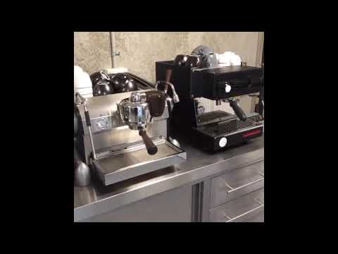

                    • panorama of various machines
                      Interesting panorama of various machines, so you can compare:⁣
                      - the Linea Mini⁣
                      - the Slayer 1 group
                      - several E61 machines⁣
                      - the Decent Espresso DE1PRO⁣
                      ⁣and see how they all look, in comparison to each other.⁣
                      Thanks to https://www.instagram.com/talkcoffee/ for the video footage.
