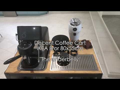

            • John, i did read thru 41 pages of this thread as much id love your machine, whats peaked my attn is your cart an the pump for the jug rinser as to how it works? Ie how does it know to turn on? Is the rinser same as regular ones connected to a mains supply? An really like the idea of your ikea cart setup!
              Pm me or post here just really interested in all of it!!
              Thanks
              • Originally posted by Sullo View Post
                Thanks
                I hook up the pitcher rinser to a flowjet, which keeps the water pressure on at all times.
                The pump automatically activates when the pitcher rinser is used. You coud likely skip the flowjet if you had access to a pressurized mains water line. I sell the parts to hook this together at https://decentespresso.com/de1xl
                I have a video showing the underside of my coffee cart, where you can see how this is wired up.
