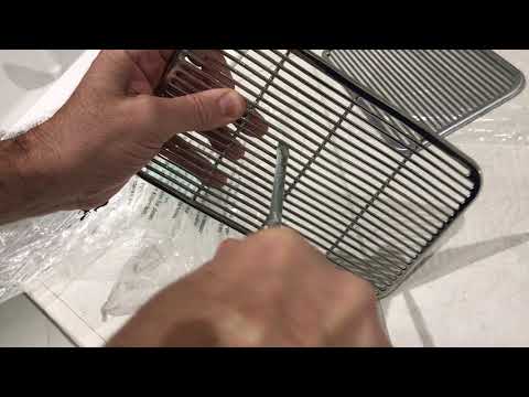

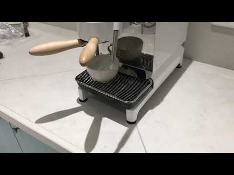

                              • Comparing drip tray covers
                                Today I received samples of all the drip tray covers we're considering.
                                I was very surprised by what I found.
                                At first blush, the "lost wax" (cast stainless steel) cover looks "more imperfect" than the "welded wires" one.
ID:	751003 Click image for larger version
                                However, in actual use, the viewing angle and background has a huge impact. The "welded wires" looks more imperfect in use.
                                I made a movie comparing the two.
                                The "lost wax" cover I received was less nice than this, when I received it. However, 6 little adjustments with a dull screwdriver (about 30 seconds work) and it looked much better.
                                What I think we're going to do next is ask the "lost wax" people if they'd be willing to make manual adjustments like this, using a jig (of our making) that mates with a cover, and repeatedly adjusting the cover until it fits properly into the jig. I don't think it'll take much time, and the result should look pretty good.
