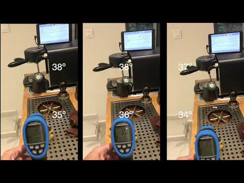

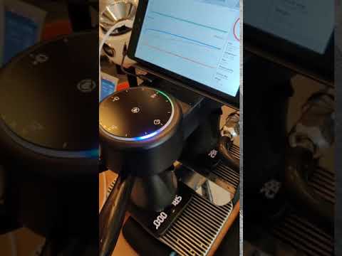

    Just slightly bad news, is that 110V machines might not see much power increase, whereas 220V customers should see a 10% speed improvement over current v1.3 firmware. But 110V customers should see more stable steam (less variation) . At least, that's been my experience.
    • I'm now down to 27 seconds to heat my 200ml latte.
    • With v1.1 I was at 46 seconds,
    • and with v1.3 previously it was at 33 seconds.
    • And more importantly, foaming quality is holding steady with good microfoam. I don't want to sacrifice quality to achieve speed.

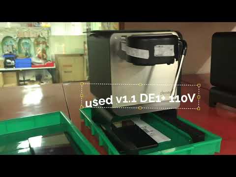

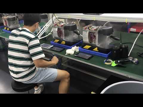

        • Testing steam on new machines
          We're creating a new workflow at the Decent factory, to figure out how to speed up our monthly production and shipping of machines.
          This week, we wired up the assembly tables with water and electricity, so that we can test the machines directly where they were built. This also lets us test multiple machines at once.
          Here new hire (started on monday) Desmond is running steam on 3 Decent machines on once, and check each tablet to make sure the flow rate and pressure is what we expect.
          The air conditioning system is on HIGH now all the time. :-D
