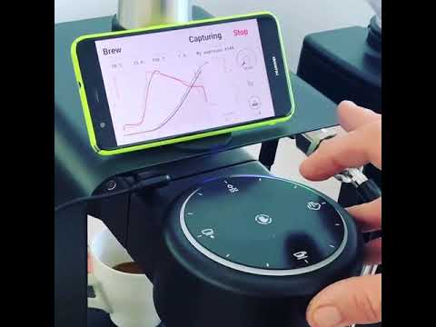

      • Good progress from the Smart Espresso Profiler folks
        https://www.naked-portafilter.com/sm...esso-profiler/
        They're offering a great software program for guiding Decent users through real time control.
        Here they're imitating a shot from the Profitech Pro800.
        Once released, this software will be free for all Decent Espresso users, though it does require the Group Head Controller, which we launched in January 2020, with our v1.3 machines.
        UPDATE: Gabor released a new video, using the DE1 + SEP to imitate the La Marzocco Leva
        https://www.instagram.com/p/CE1su97BbOX/
