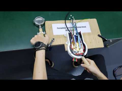

  • Portafilter alignment jig
    A few months ago we had a problem with our portafilters not locking in a position that was symmetrical to the group head handle.
    This was caused by a 0.2mm difference in thickness in a fiberglass insulating spacers board we use to regulate this.
    We had to disassemble all the group heads and rebuild them with newly sourced spacers, which took several people, several weeks to do.
    So Decent R&D engineer Alex designed, 3d printed, and built this jig.
    It will go to our group head CNC manufacturer so they can now quickly test that the alignment is correct. The green area shows the acceptable range, whereas the red area means "not acceptable"

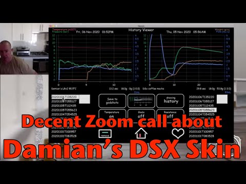

      • Damian's DSX Skin (zoom call)
        Damian's DSX skin for the Decent DE1 is a favorite among power users. Here's a deep dive into every aspect of it, from the creator himself.
