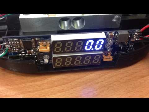

          • Here's a short movie of us testing the button interface to our upcoming Decent Scale: https://decentespresso.com/scale
            The idea is for one button to control the timer (on the right) and another button to control the tare weight feature.
            There are a few button presses too many on the timer, and the "weight currently changing" LED should stay on for a second longer (since espresso can drip in slowly), but otherwise this is close to OK for me.
            Any comments?
                Any comments?
                It looks like:
                • 1st press: Start
                • 2nd press: Stop
                • 3rd press: Reset
                Would it be less complicated to use a press for start/stop (i.e. pause/unpause) and press+hold for reset?
                  It looks like:
                  • 1st press: Start
                  • 2nd press: Stop
                  • 3rd press: Reset
                  I'd rather not require people to learn to hold a button down for a while to have a different action. In my ideal world, one button does one thing.
                  My plan, though, is to change the 3rd press into a reset. The workflow then becomes:
                  1st press: timer LED turns on and starts counting time
                  2nd press: timer stops, LED stays on, final time is displayed
                  3rd press: timer is reset, and starts counting time (ie, step 1)
                  In other words, the timer button is a START-AT-ZERO/STOP button. There is no feature to unpause, since I think this is not a very used feature.
