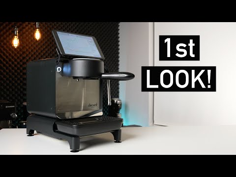

    • I find that a lot of the strengths of the DE1 aren’t really leaned into and presented on YouTube or other mediums with the same gloss as say a LM even though I know now how restrictive a LM is.
      That's a fair criticism. I'm been wary of describing yet more features of the Decent, as people already feel we're extremely feature rich, bordering on "too much" for new customers.
      as far as overviews go, I think that 3rd party videos do a better job than we do.
      For example, this recent video beats anything I could hope to produce:
