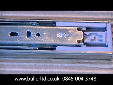

                            My favorite idea is to put the tank on runners, so you push it in, hear a click, and it stays put. Then, push it again to have it pop out. Here's a video of what I mean:
                            However, that's going to take some R&D to get right, and I want to kill all the R&D that I can so that we can move to shipping.
