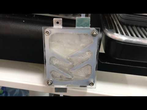

                • Testing our flush diffuser
                  We're trying to slow down the high pressure water after an espresso shot, so you don't get splashed when the water goes into the drip tray. Here's a slow motion video of our prototype idea, where water goes into a kind of cyclone, and can't exit until it slows down, because the hole is in the opposite direction of the cyclone. This is one of the last things on our "to-figure-out" list before our design freeze in a few days.
                  • I worry things like this will eventually clog with gunk and be a maintenance issue. Any thoughts?
                    • clogging worries
                      It's definitely a possibility, yes. We're going to keep the plastic cover on it, easily removed, even for customers, so you can see if there's any clogging and easily clean it. You can get at this part by simply removing the top cover, no other disassembly needed.
                      However, group head flushes tend to be "grey water" and not so particulate heavy. In that video, that's real flush water you're seeing, from an espresso that just finished.
                      I didn't mention it, but that diffuser has been in constant use for about week, and it's still pristine.
                      In case you're curious, here's where the flush diffuser will sit, it's quite easily accessible.
                      The diffuser is located in such a way that if it really clogs constantly, and that just can't be helped, then a longer tube from the flush valve can be swapped in and send higher velocity water directly into the drip tray. If that's ever needed
                      , we'll send you the part and you just need a pair of needle nose pliers to take the clip out, put a new tube in, and reclip it.

                              "Automatic channel healing"
                              When espresso is being made, sometimes these channels open up (sometimes called "crevasses"), where water spurts out. This (a) tastes bad and (b) makes a mess. Here's a photo:
                              when we detect a jump in water flow, we back off the pressure immediately, which generally causes the coffee to fill in and for the channel to "heal". We can only do this because of our use of vibratory pumps, which are like pistons, because we can instantly stop pumping and start again 1/10th of a second later. Traditional pumps can't do this.
