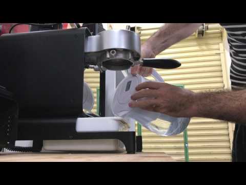

          I've been asked many times "how do you fill the water tank on the decent espresso machine?" So I made a movie today showing how.
          Thanks for posting. Does the drip tray lock in or is it just sitting there and subject to movement or knocking?
          • Originally posted by JMcCee View Post
            It passes by very quickly in the video, but at 0:01 you can see that there are large "dimples" in the bottom front of the drip tray.
            These fall into cut outs in the leg rails and thus lock it into place.
            Here's a screen picture and I've put an arrow to them.
Name:	screen 2017-06-03 at 2.25.54 PM.png
                [ATTACH=CONFIG]16187[/ATTACH]
                I like it. Thanks for clarifying.
