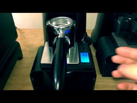

                              We're almost finished developing our Decent Grinder https://decentespresso.com/pro_grinder where we take a good quality pro grinder made by someone else (a Chinese company owned by Mahlkonig) and modify it so that you can see the weight as you're grinding. It's a simple feature, but surprisingly useful, since consistent coffee ground dose weight is crucial to making good espresso. In this video, Jeffrey shows his latest idea, a slot for easily moving the scale (and portafilter stand) sideways so that the coffee grounds pour into the center of the portafilter. Front to back adjustment is made by loosening the screws on the feet of the grinder so that you can slide the entire scale stand forward and back.
                              This grinder is non-automatic. You turn the grinder on, and then off when the dose weight is what you want. The burrs are 64mm flat.
