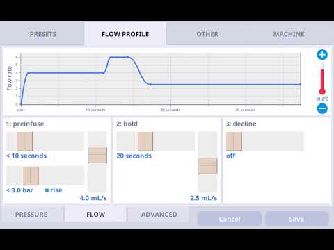

                  • Second attempt: preinfusion and flow profiling
                    Here is a new draft of the user interface for configuring pre-infusion, when making a flow controlled espresso on the DE1+. Thanks for all the feedback, it really helped.
                    What's changed:
                    - The flow bar was moved from horizontal to vertical, so it's like the other flow-bars on the page.
                    - Both seconds and max pressure are now labelled with a < and they're stacked on top of each other, to make it clear that they both apply.
                    - The "guarantee" concept has turned into a "rise" checkbox which simply means the DE1+ should try to "rise" the espresso to this pressure (at the end of preinfusion)
                    I've made a small animation showing how the chart changes as you turn this "rise" feature on and off.
                    What do you think?

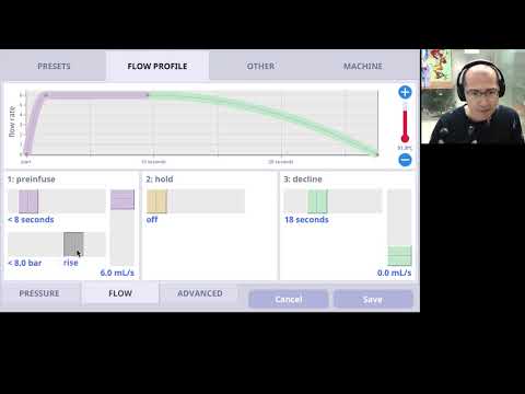

                    • Color coding an espresso profile
                      A few days ago Michael Hollesen suggested color coding the espresso sections and uploaded a photoshop mockup he made of his idea.
                      I liked where he was going with it, and today tried to implement something similar.
                      Let me know what you think of this direction.
                      • The colours are a great idea to make the interface more intuitive. I think it would be nicer to have the same weight line as the blue but make it coloured instead of the cloud around the line. I think red for preinfusion, green for hold, blue for decline. You could even have the rise function a different shade of red with that section of the line matching if enabled.
                          I tried that, but because the same color is used on the thin line as on the big square buttons, if I use a color vivid enough to be seen on a thin line, it is LOUD and a bit vulgar, when the same color is placed on a larger area.

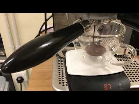

                          • Tracking flow rate into the cup
                            This video demonstrates our ability to integrate with a Bluetooth scale, and thereby chart the real-time flow rate of an espresso into the cup itself. The scale weight is automatically tared when the shot starts, and you can see the drops start around 8 seconds of preinfusion and speed up to approach the water flow rate as measured going into the puck from the machine.
                            Note that the blue flow rate line is calculated on this machine (not using a hardware flow meter) as we are trying to create an accurate physics model to determine flow rate by counting water pump strokes. We wrote this "gravimetric flow meter" in order to test and improve our physics model.
                            We are working on making our own Bluetooth scale, as well as an integrated scale in the drip tray of our upcoming DE1CAFE model.
                            Naturally, in the future, the espresso machine can stop making coffee when the desired in-cup rate is reached.
