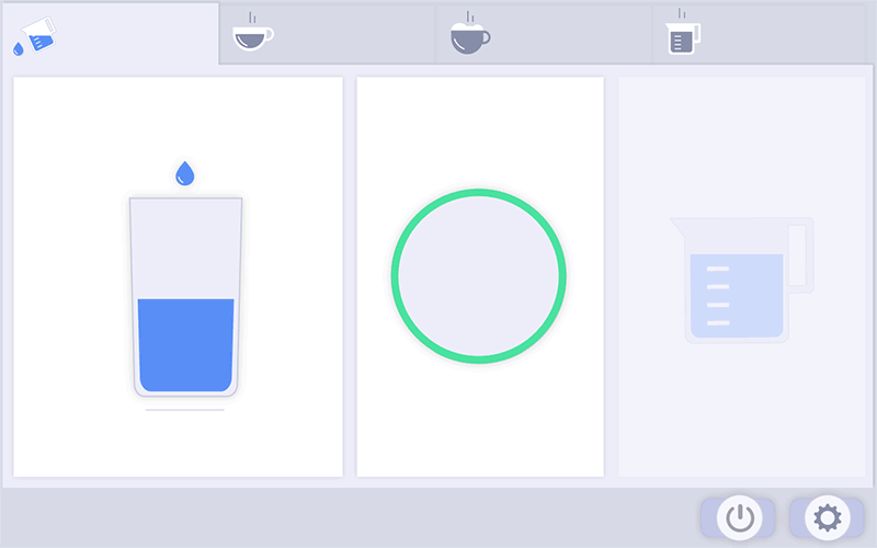

                • Flat UI be gone
                  A few weeks ago, the Nielsen Norman Group published a study indicating: "The popularity of flat design in digital interfaces has coincided with a scarcity of signifiers. Many modern UIs have ripped out the perceptible cues that users rely on to understand what is clickable." https://www.nngroup.com/articles/fla...e-uncertainty/
                  I found the study very convincing, as I've found my iPhone harder to use since they've made all the UI elements "flat".
                  In early September, I changed the Decent Espresso web site's "CSS Theme" to use drop shadows on the buttons (previously, buttons were "flat"). I sat back and waited for the complaints to roll in. They didn't, and the "how do I buy something on your website?" tech support messages seemed less frequent.
                  On our espresso GUI, I've often found it a bit hard for the to track "what should I do next" ?
                  Today, I've taken the Nielsen Norman Group advice to heart on our espresso machine tablet software, and all "tappable" buttons and tappable icons have a 3D "lift" to them. I'm hoping this makes it a bit easier for baristas to intuit what to tap on.
                  Below are some animations showing the DE1+ gui and also all the configuration pages. FYI I use photoshop to make the tablet GUI, and its animation feature to test what common commands might look like to the user.
