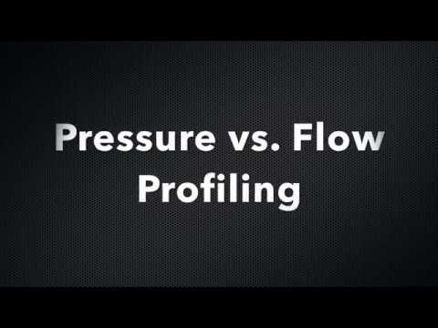

            • DE1+ owner Damian Scisci has a new video: Pressure vs. Flow Profiling

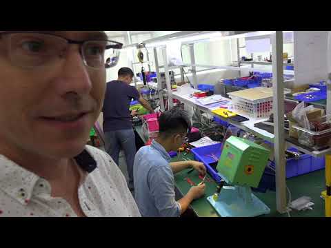

                      • factory progress
                        Originally posted by gc View Post
                        Thanks for that info John. As it's 10:30 pm here I'll give us both a break and look into it tomorrow on a bigger screen and also try the update button. Enjoy your evening.
                        I seem to have fixed the obvious bugs in ADVANCED PROFILE, so it's safe to try out now.
                        In other news, there's real factory progress to report this week.
                        3 new people started this week, and we pulled all the engineers away from their desks, so we could have 10 total people working on building machines. That's a big increase from 2 people in the factory previously.
                        We believe we will have all the "sub assemblies" for 20 machines built by the end of Friday (today), and on Monday we will start final assembly of them all. We should have shipped all 20 220V machines by the end of next week.
                        If so, that will represent a 4x increase in assembly speed (from 0.5 machines/day to 2 machines/day), but we think we should reach 3 to 4 machines a day very shortly, because quite a bit of the past 2 weeks has been us cleaning and organizing. That's mostly done now, and we can start to reap the benefits.
                        Attached are some photos I took today.
