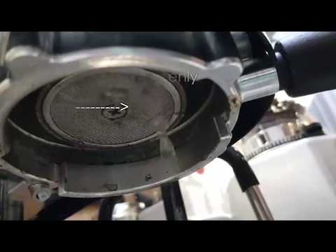

      • Tech support video: a dirty shower screen can cause uneven espresso water
        Shin (our man in Korea) was demoing to some serious baristas, who were unimpressed that the water coming out of the shower screen was so uneven. After a bit of head scratching, we found that taking out the shower screen and cleaning the coffee off of it fixed the problem.
        (n.b.: this is an example of how we're planning on doing most tech support. A short video shows the problem, and the solution. Few words or language necessary. The next revision of this video will show the parts being cleaned. Great for our many customers for whom English is not so easy)

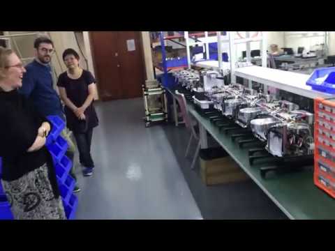

                              • 20 espresso machines
                                This was the first time we've built 20 machines at once (previous time was 5 at once). We were pretty excited to get them all done, and 3 new hires started last week, helping with this.
