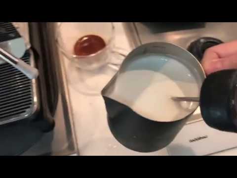

              • Hands-free milk steaming for two lattes
                With a larger milk jug (600ml) I can easily steam hands-free using this technique. No stand required.
